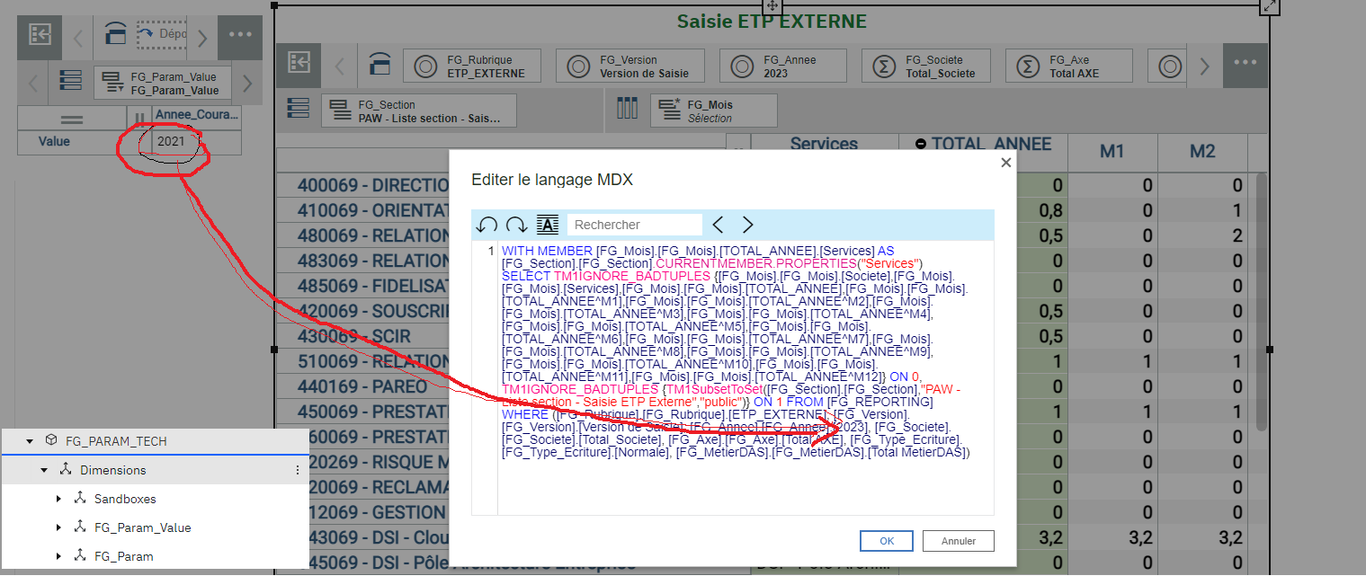

I want to insert the value of measure "Current_YEAR" of cube "FG_PARAM" to MDX to make the MDX change with my selector. Can some one give me 1 exemple?
for exemple : if i have 2021 in cube "FG_PARAM", the MDX take the value 2021
question MDX.png (200.59 KiB) Viewed 1562 times
Any help will be appreciated!!
Thanks a lot.
Code MDX before
WITH MEMBER [FG_Mois].[FG_Mois].[TOTAL_ANNEE].[Services] AS [FG_Section].[FG_Section].CURRENTMEMBER.PROPERTIES("Services")
SELECT TM1IGNORE_BADTUPLES {[FG_Mois].[FG_Mois].[Societe],[FG_Mois].[FG_Mois].[Services],[FG_Mois].[FG_Mois].[TOTAL_ANNEE],[FG_Mois].[FG_Mois].[TOTAL_ANNEE^M1],[FG_Mois].[FG_Mois].[TOTAL_ANNEE^M2],[FG_Mois].[FG_Mois].[TOTAL_ANNEE^M3],[FG_Mois].[FG_Mois].[TOTAL_ANNEE^M4],[FG_Mois].[FG_Mois].[TOTAL_ANNEE^M5],[FG_Mois].[FG_Mois].[TOTAL_ANNEE^M6],[FG_Mois].[FG_Mois].[TOTAL_ANNEE^M7],[FG_Mois].[FG_Mois].[TOTAL_ANNEE^M8],[FG_Mois].[FG_Mois].[TOTAL_ANNEE^M9],[FG_Mois].[FG_Mois].[TOTAL_ANNEE^M10],[FG_Mois].[FG_Mois].[TOTAL_ANNEE^M11],[FG_Mois].[FG_Mois].[TOTAL_ANNEE^M12]} ON 0, TM1IGNORE_BADTUPLES {TM1SubsetToSet([FG_Section].[FG_Section],"PAW - Liste section - Saisie ETP Externe","public")}
ON 1 FROM [FG_REPORTING] WHERE ([FG_Rubrique].[FG_Rubrique].[ETP_EXTERNE], [FG_Version].[FG_Version].[Version de Saisie]
, [FG_Annee].[FG_Annee].[2023], [FG_Societe].[FG_Societe].[Total_Societe], [FG_Axe].[FG_Axe].[Total AXE], [FG_Type_Ecriture].[FG_Type_Ecriture].[Normale], [FG_MetierDAS].[FG_MetierDAS].[Total MetierDAS])
something that i want to, MDX change when i change the value of selector to 2021
, [FG_Annee].[FG_Annee].[2021], [FG_Societe].[FG_Societe].[Total_Societe], [FG_Axe].[FG_Axe].[Total AXE], [FG_Type_Ecriture].[FG_Type_Ecriture].[Normale], [FG_MetierDAS].[FG_MetierDAS].[Total MetierDAS])

This should help you figure out what you need.
My front end selection cube is dimensioned by user which enables your PAW screens to support multiple users.
'{TM1Sort(
{[Funding Budget Group].[All],
TM1FILTERBYLEVEL(
Descendants({StrToMember("[Funding Budget Group].["+[Front End Selection].(StrToMember( "[}Clients].[" + USERNAME + "]" ) ,[Front End Selection].[Funding Budget Group]) +"]")}) , 0)},
ASC)}';
The bold piece is the reference to the front end cube.
The Italic piece converts the the text that is returned from the bold section into a member of the dimension concerned.
