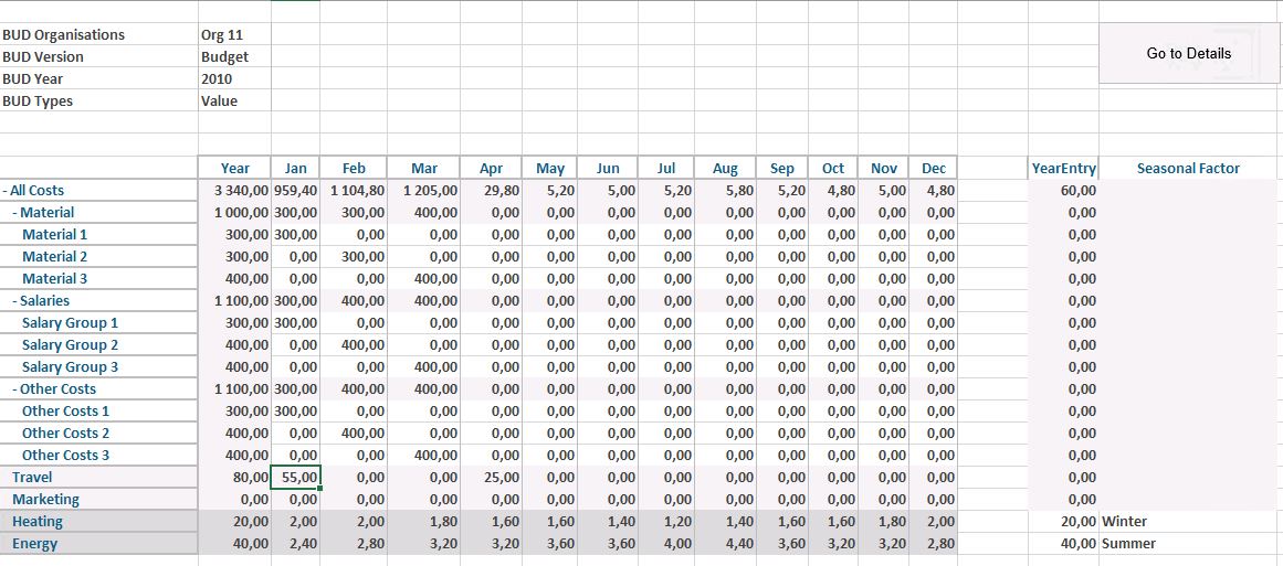

The example is taken from TM1 Official Guide
I put Cursor in the cell of Travel row (Cube1)
Click the Button Go To Details

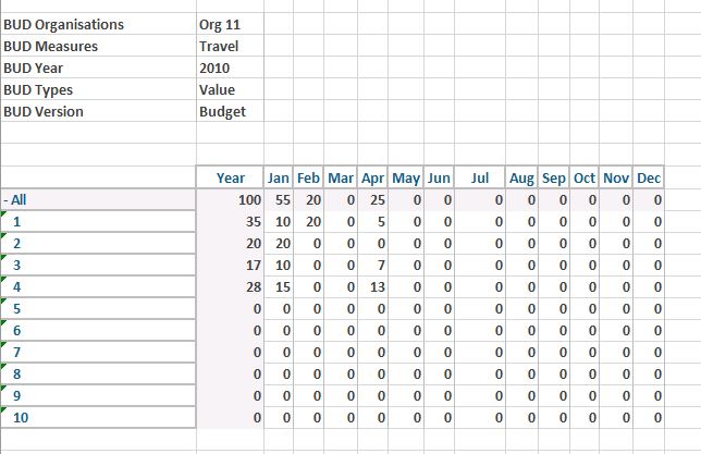

List appears (Cube 2 Appears with the same dimensions + 1 dimension of rows). And it shows the same Travel element in Context

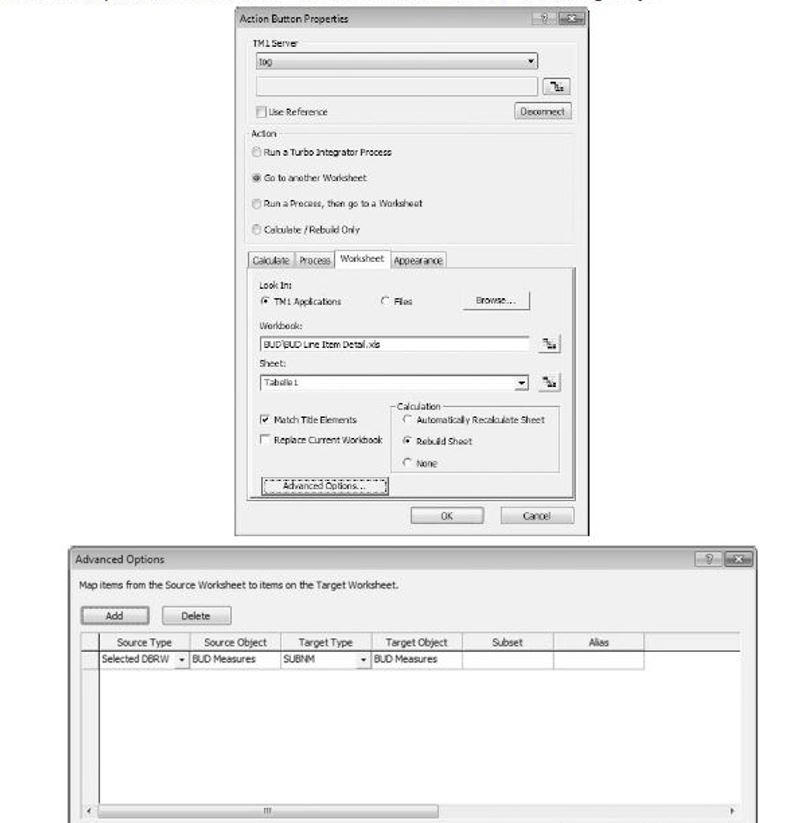

It is made by Advanced Options of Actions Button
Is it possible to do the same thing it PAW? I tried synchronize but it works for context Dimensions but it doesn't work than the filter element (Travel) in row (like in Example)

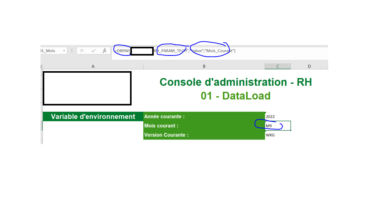

the solution is you can save your selected subnm in TM1 and make a process that write this selected in the new page.
In the new page, dont use the subnm but use DBRW to get your saved selected and make a process that write a selected value while click in button ==> sorry for my bad english :mrgreen: if this is not clear, feel free to ask me again :mrgreen:
for info, action button have "Context pass" option to pass context for any items that have synchronization enabled in both the current tab and the destination tab.
it is not the same thing of advanced option and it will not be very helpful in your case, because you want to pass context from a dimention to another.
