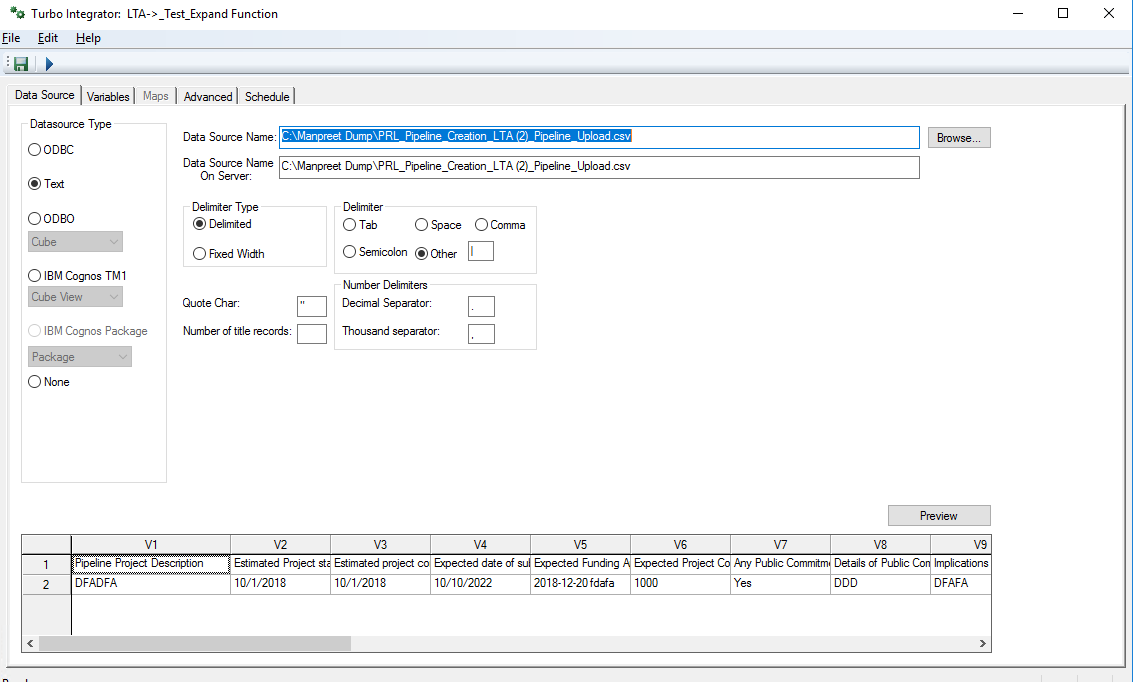

Data source Tab screenshot in TI.
TI Data Source Tab.png (41.71 KiB) Viewed 6447 times

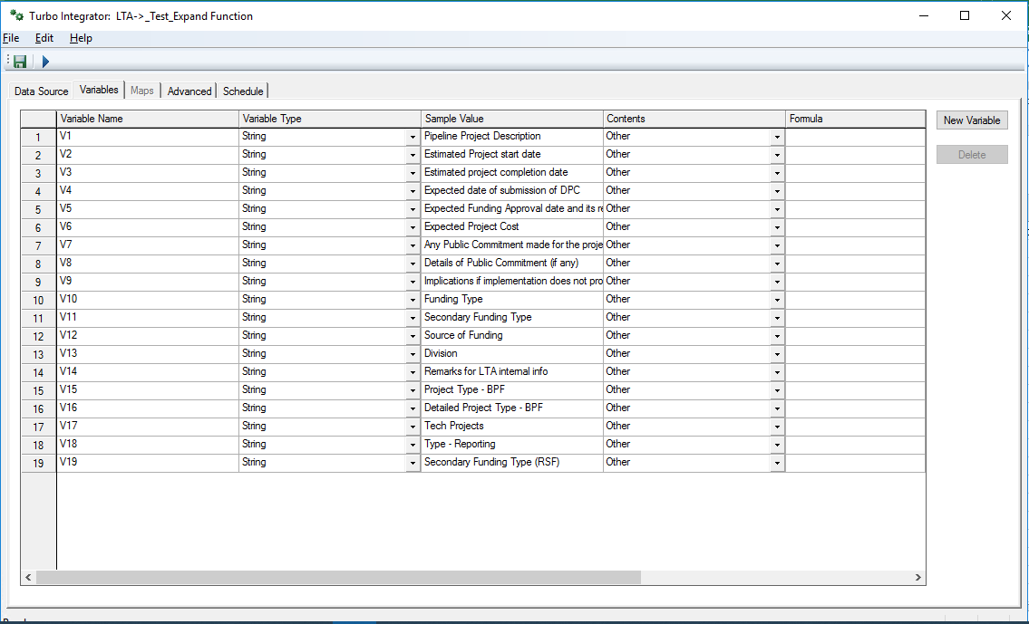

Variable Tab Screenshot in TI.
TI Variable Tab.png (53.77 KiB) Viewed 6447 times

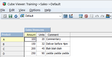

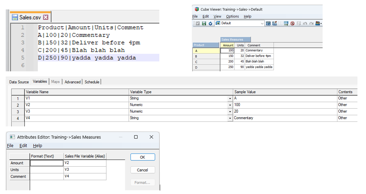

Had some time this morning to explain my thoughts better:
Starting with a file containing my data per below in Sales.csv.
I have Product which is my "key" and 3 other columns I need to import into my Sales cube.
I create a new TI and name the variables simply V1, V2, V3, etc.
I then set the attributes on my Sales Measures to align to V1, V2, V3 etc. per my Sales Data:
Sales Part 1.png (196.23 KiB) Viewed 6341 times
Back in my TI I can write the code needed to process each field in the source file and write it to the mapped Sales Measures:
sProduct=V1;
nIndexMax=4;
nIndex=1;
WHILE(nIndex<=nIndexMax);
	sDataSourceVariable='V' | NumberToString(nIndex);
	sDataSourceData=Expand('%' | sDataSourceVariable | '%');
	#--Get the measure name from the alias if it exists
	sMeasure=DimensionElementPrincipalName('Sales Measures', sDataSourceVariable);
	IF(sMeasure@<>sDataSourceVariable);
		#--Deal with numeric and strings separately
		IF(DType('Expense Measures', sMeasure)@='N');
			nFieldValue=NUMBR(sDataSourceData);
			CellPutN(nFieldValue, 'Sales', sProduct, sMeasure);
		ELSE;
			CellPutS(sDataSourceData, 'Sales', sProduct, sMeasure);
		ENDIF;
	ENDIF;
	#--Left this in to allow review and testing
	asciioutput('debug.txt',sDataSourceVariable, sDataSourceData, sMeasure);
	nIndex=nIndex+1;
END;
After running my code I have the following:
Sales After Import.png (14.3 KiB) Viewed 6341 times
Hope that illustrates better what I was trying to explain.
Apologies for the collage - post would not let me add more than 3 images
