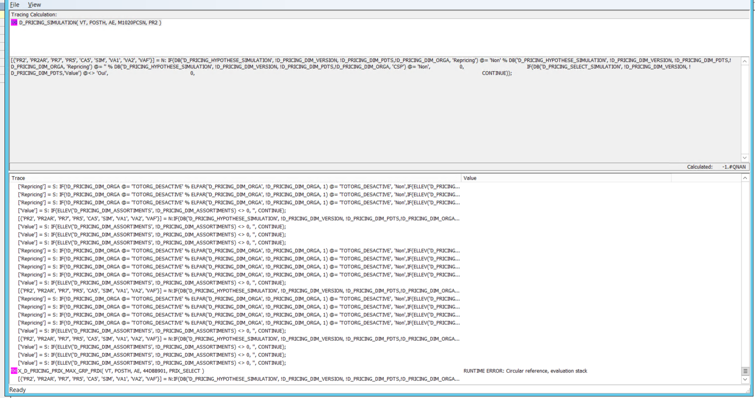

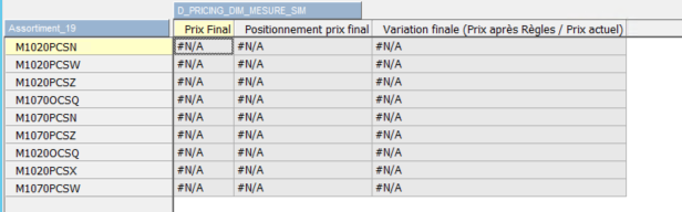

hi,
today, i got this error that i never seen that before, so, any help or any exp will be appreciated ! :idea:
thanks !
my trouble
trouble rule.png (45.29 KiB) Viewed 6762 times
trouble rule 2.png (568.71 KiB) Viewed 6762 times

Thank maren for the reponse, problem solved, i found that i compare A with B while B is calculed by A. but i still dont understand why it cause reference circular error.
B = A * coefficient (0,1-1)
i have a condition if (B>A), B, A.
I still need to do this and i need to understand why there are a reference circular here. :ugeek:
Thanks !

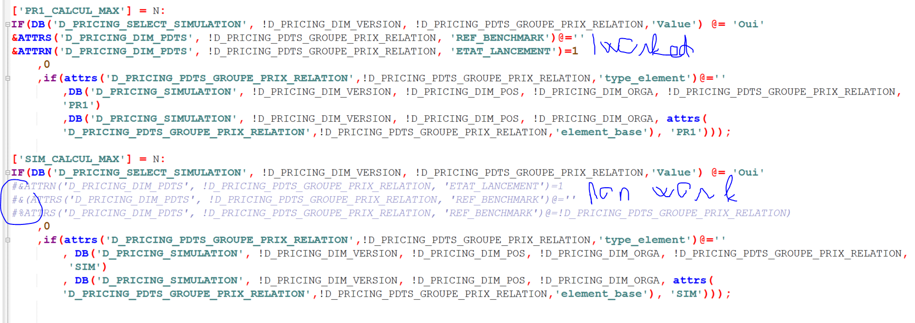

Thank for the explain! i have it something in excel formula but this is a first time i have in TM1, i have no idea why a condition can make a reference circular while it work on 1 but not other
probleme is on this line, but this line dont make the trouble in the first case (PR1 MAX)
rule line error.png (374.7 KiB) Viewed 6601 times
['PR1_CALCUL_MAX'] = N:
IF(DB('D_PRICING_SELECT_SIMULATION', !D_PRICING_DIM_VERSION, !D_PRICING_PDTS_GROUPE_PRIX_RELATION,'Value') @= 'Oui'
&ATTRS('D_PRICING_DIM_PDTS', !D_PRICING_PDTS_GROUPE_PRIX_RELATION, 'REF_BENCHMARK')@=''
	,0
	,if(attrs('D_PRICING_PDTS_GROUPE_PRIX_RELATION',!D_PRICING_PDTS_GROUPE_PRIX_RELATION,'type_element')@=''
		,if(DB('D_PRICING_SIMULATION', !D_PRICING_DIM_VERSION, !D_PRICING_DIM_POS, !D_PRICING_DIM_ORGA, !D_PRICING_PDTS_GROUPE_PRIX_RELATION, 'SIM')<DB('D_PRICING_SIMULATION', !D_PRICING_DIM_VERSION, !D_PRICING_DIM_POS, !D_PRICING_DIM_ORGA, !D_PRICING_PDTS_GROUPE_PRIX_RELATION, 'PR1')
			,DB('D_PRICING_SIMULATION', !D_PRICING_DIM_VERSION, !D_PRICING_DIM_POS, !D_PRICING_DIM_ORGA, !D_PRICING_PDTS_GROUPE_PRIX_RELATION, 'PR1')
			,DB('D_PRICING_SIMULATION', !D_PRICING_DIM_VERSION, !D_PRICING_DIM_POS, !D_PRICING_DIM_ORGA, !D_PRICING_PDTS_GROUPE_PRIX_RELATION, 'SIM'))
		,DB('D_PRICING_SIMULATION', !D_PRICING_DIM_VERSION, !D_PRICING_DIM_POS, !D_PRICING_DIM_ORGA, attrs('D_PRICING_PDTS_GROUPE_PRIX_RELATION',!D_PRICING_PDTS_GROUPE_PRIX_RELATION,'element_base'), 'PR1')));
Anyway, thanks for your help ! now, i know where is the problem, i will just delete it and try to make another way. i'am not very smart on math :mrgreen:

Bit puzzled why the REF_BENCHMARK ATTRS for D_PRICING_GROUPE_PRIX_RELATION would be asking if it was equal to itself?
If you removed that ATTRS does it work then?
Other than that not enough information to provide an answer and as others have already said, not something anyone has time for really.

- Bit puzzled why the REF_BENCHMARK ATTRS for D_PRICING_GROUPE_PRIX_RELATION would be asking if it was equal to itself? ==> because i have to apply this rule only for the element who have himself in the attribut REF_BENCHMARK
- If you removed that ATTRS does it work then? => it work if i romove that ATTRS, this is why i dont understand :mrgreen:
==> i will try another way to do this thing or use a TI.
Thanks your help !
