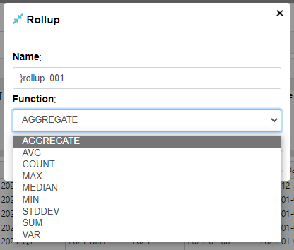

There are functions which MDX can deliver quite easily which TM1 rules either can't deliver unless you go back to 1st principles algebra (e.g. standard deviation) or where it simply isn't worth writing a separate rule for or for things like min/max/count/average where the relevance of the analysis is on the current set and level of the members beig queried and not on the whole cube.
And creating a MDX based calculation is as easy as this.
Screenshot 2022-10-12 150124.png (15.39 KiB) Viewed 12064 times
