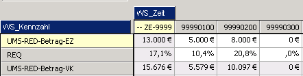

Hey together,
actual having an issue with my rule / porportional data spread.
My example cube is simple, just 2D with 3 measures and a time-dimension with 12 month and a year element.
My rule:
['REQ'] = C: (['UMS-RED-Betrag-vK'] - ['UMS-RED-Betrag-ez']) \ ['UMS-RED-Betrag-vK'];
['UMS-RED-Betrag-vK'] = N:['UMS-RED-Betrag-EZ'] \ (1-['REQ']);
Doing a prop. spread on tm1 "REQ" / "ZE-9999" will cause the following Error:
Spreading failed due to conflicts with rules.
I already tried to write the rule in different ways, but I couldn't solve it...
Do you guys have an idea how I have to change my rule to fix this and get the correct output?
Thanks!
Best regard
tm1nb
