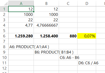

This is the "difference":
I would not lose any sleep over this 0.07%.
I'm certainly not an expert on this.
Could it be the case that some numbers are slightly higher than the original number ? Where the effect would be the inverse and the total net effect almost zero (even less than the above) ?
Also, when the customer is validating, I guess they will use formulas to calculate the rounded percentage difference and anything that is too small will be deemed okay.

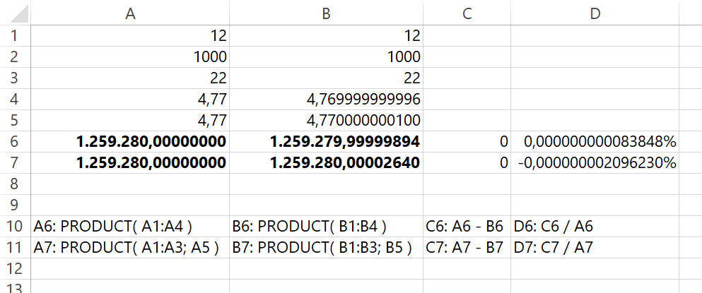

I think at some point you hgave transposed some 9s to 6s.
Originally you say 4.769999999996 (but from the screenshot it is 4.7700000000999996). But then in a later post you quote 4.7666666669. This number can't be correct and if this is the case the difference (althoug as Wim says only 0.07%) is far too large to be due to floating point. There is something else going on, or you just made a typo.
If the real number is either of the first 2 then as stated already this is really a non-issue. It's just how computers store and calculate decimals.
Indeed Lotsa.
In retrospect, I already had a feeling that the deviation was still way too big. Even if only 0.07%. But no time to look at it in detail so thanks for picking up the difference.
Updated figures with 2 situation for the 4.77. The people that have an issue with this, will probably have many many more issues in life ;-)
