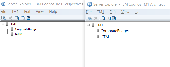

Screenshot 2022-07-26 084612.png (18.27 KiB) Viewed 5420 times
I wonder if there's a way to increase the font size on the left, which is Perspectives running in Citrix Workspace. The right side is Architect running on Windows desktop. Note font size for title bar, menu etc. are the same between the two but not inside.

Thanks! But unfortunately, I don't think it addressed my issue.

For what it's worth, and this is not Citrix related ...
I have an external 4K screen as well as the laptop screen. If I start Excel with both screens active then I get small fonts in Perspectives. But if I switch to a single screen, fire up Excel and then switch to a second screen I get the larger fonts in Perspectives. I believe it's related to the font scaling in Windows (which is different for each screen) but until I accidentally discovered this little "trick" it was driving me up the wall!
