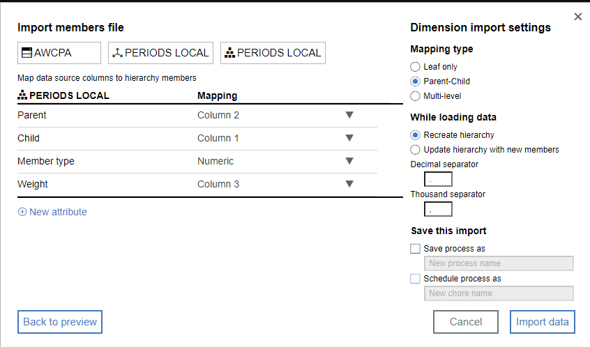

I expect what you have here is for Line (2) - you are using a ComponentAdd to make "Q2 23" a child of "Q2 23 vs Q2 22".michaelc99 wrote: ↑Tue May 24, 2022 7:11 pmCode: Select all
Line 1: "Q2 23 vs Q2 22","","0" Line 2: "Q2 23","Q2 23 vs Q2 22","1"Code: Select all
line (2): Dimension Element "Q2 23 vs Q2 22" not numeric.
But you have created "Q2 23" as a String element.
George has already alluded to this but will try and "double down" on it.
This is a relatively common misunderstanding I have seen when people get into development with Planning Analytics.
The key thing to understand is the types Numeric or String don't relate to the element itself, but the type of data you will hold against it.
So even though the name of the element includes the letter Q, that does not make the element a String.
Any hierarchy/dimension that will include roll-ups (parent/child relations) will be C and N elements (consolidated and Numeric/Nodal.)
Think of this as being that a Roll-Up is a simple calculation - the calculation is performed on the data in the cells of the cube. It would be impossible to "consolidate" text.
The only time you ever need to use S (string) is in a measures dimension (the last dimension in a cube) - as that is the one that dictates whether the cell intersections are text or numbers.
Re: Hierarchy Maintenance in PAW or TI?
As Declan has pointed out this is your problem. The data type of the field that holds the element name may be a string, but the element itself when added to the dimension should be either N for leaf (numeric) or C for a consolidation.michaelc99 wrote: ↑Tue May 24, 2022 7:11 pm I set the elements to String during the rebuild dimension process, so I am scratching my head on this one.
If you add elements of type S they can't be added to consolidations.
S elements can still store numeric data as the element typing between N and S only affects the type of data the cell can store when the dimension is the last dimension in the cube.

When I looked at the Import Options (see attached) I initially thought it referred to the data type itself as String versus the element when being added to the dimension as either N for leaf (numeric) or C for consolidation. I rolled back my changes to mirror PROD, then went back to the Import Options, set it to Numeric and it imported successfully!
I'll go ahead and perform testing to ensure that it matches expectations, but I wanted to thank you all for your responses and helpful advice! I greatly appreciate it!
