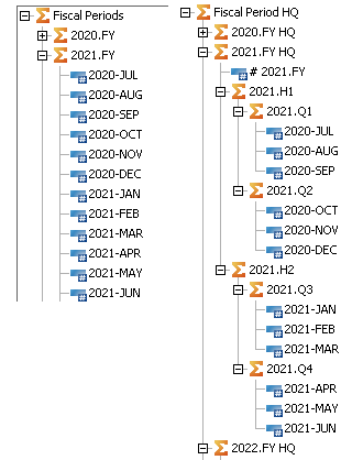

My Period dimension is deliberately designed with leaf elements as YYYY-MMM e.g. 2021-JAN - these do not sort chronologically and is perfect for some examples.
Also, I have assumed a July start or Period 1.
My Period dimension has multiple rollups grouping Periods into Fiscal Years as well as Periods into Quarters, Halves and Fiscal Years.
These have also been configured in the }HierarchyProperties cube to drive some of the Level queries.
You can create your own Period dimension per below to play with the examples.

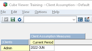

I also created a basic Client Assumption cube to read the Current Period for the user in some examples.
You could create this per the below cube view.
