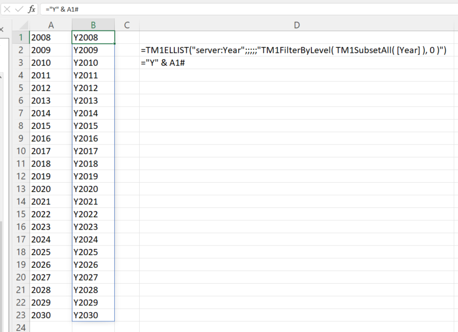

Re: PAfE API: RefreshSheet
In the past I have used such code (with a recent Excel version):
Sub create_ellist()
    Dim vMDX As String
    vMDX = "TM1FilterByLevel( TM1SubsetAll( [Year] ), 0 )"
    'creating a TM1ELLIST function as a dynamic array
    Range("A1").Formula2 = "=TM1ELLIST(""servername:Year"",,,,,""" & vMDX & """)"
    Range("B1").Formula2 = "=""Y"" & A1#"
End Sub
Notice the blue border around the dynamic array formulas.
Sample output:

Wim Gielis wrote: ↑Wed May 11, 2022 10:01 pm
Debug.Print Range("K2").SpillingToRange.Address(0, 0)
Range("K2").SpillingToRange.Value = Range("K2").SpillingToRange.Value
This is fantastic, thank you for sharing.
You are right, in VBA it's not easy to bring up a cell and the cells below.
I would consider:
Sub test()
    Dim r As Range
    With ActiveCell
        If IsEmpty(.Offset(1).Value) Then
            Set r = .Cells(1)
        Else
            Set r = Range(.Cells(1), .End(xlDown))
        End If
    End With
    MsgBox r.Address
End Sub
