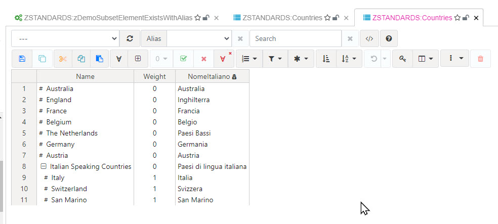

Take the following example; a dimension of countries with principal names in English and an alias of NomeItaliano which shows the names in Italian.
OK, now consider this code where I use the NomeItaliano attribute to punch the elements into a subset named ItalianSpeakingCountries. I then check the existence of the elements in the subset using the same aliases that I used to insert them:

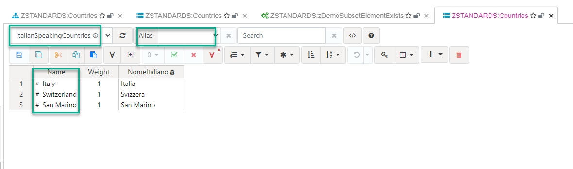

Now, the subset itself is exactly what I would expect; no alias, with the elements that I inserted - albeit the principal names of those elements:
Now check what came out in the log file:
"The subset ItalianSpeakingCountries has been created in the dimension Countries, with an alias of ""."
"The element Italia is NOT in the subset ItalianSpeakingCountries."
"The element Italy IS in the subset ItalianSpeakingCountries."
"The element Svizzera is NOT in the subset ItalianSpeakingCountries."
"The element Switzerland IS in the subset ItalianSpeakingCountries."
Even though I added the alias Italia, that alias is NOT reported as being part of the subset; only the principal name Italy is. The same with Svizzera rather than Switzerland. Yes, true, I've observed previously that despite Italian being one of the 4 official languages of Switzerland, the only people who speak it north of Lugarno are me (if I happen to be visiting) and reruns of Il commissario Montalbano. However I don't think that's the cause of this problem.

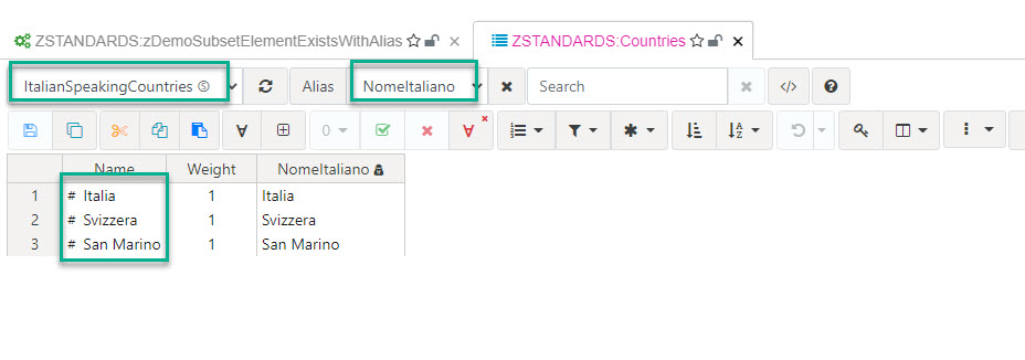

So here's the newly recreated subset WITH its alias:
Buuuut.... here's the log:
"The subset ItalianSpeakingCountries has been created in the dimension Countries, with an alias of "NomeItaliano"."
It still doesn't recognise the alias names as being part of the subset, it still only recognised the principal names.
