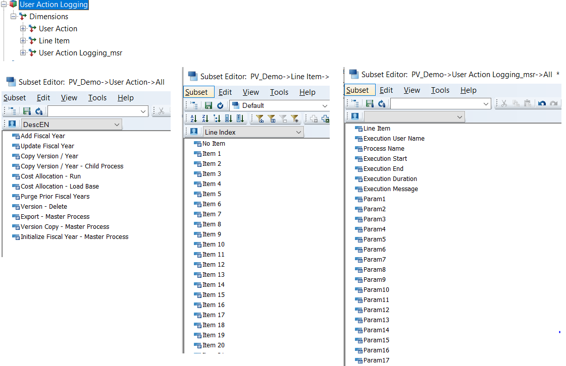

I have a cube called User Action Logging with 3 DImensions: User Action, Line Item and a Measure dim:
User Action Logging All.PNG (79.39 KiB) Viewed 202263 times

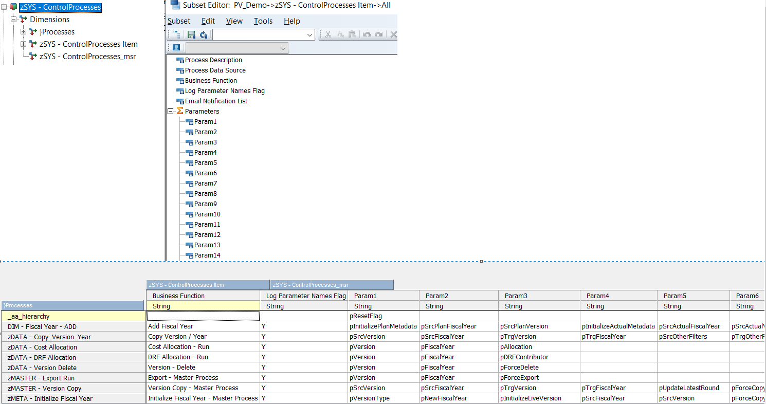

Also I create a cube with }Processes as one of my dimensions, another dimension to be used to map the Process Name to a User Friendly User Action Name and also names of all Parameters (up to 30 params) used in the process.
zSYS - ControlProcesses All.PNG (68.15 KiB) Viewed 202263 times
In the cube above (zSYS - ControlProcesses), the first 5 Items are populated manually, and the Parameter Items are loaded with a TI Process, which parses the respective PRO File of the process to identify the Param Names used in the process. The process is parameterized and it should be executed only if the process parameter names have changed. Usually after the Process is deployed.

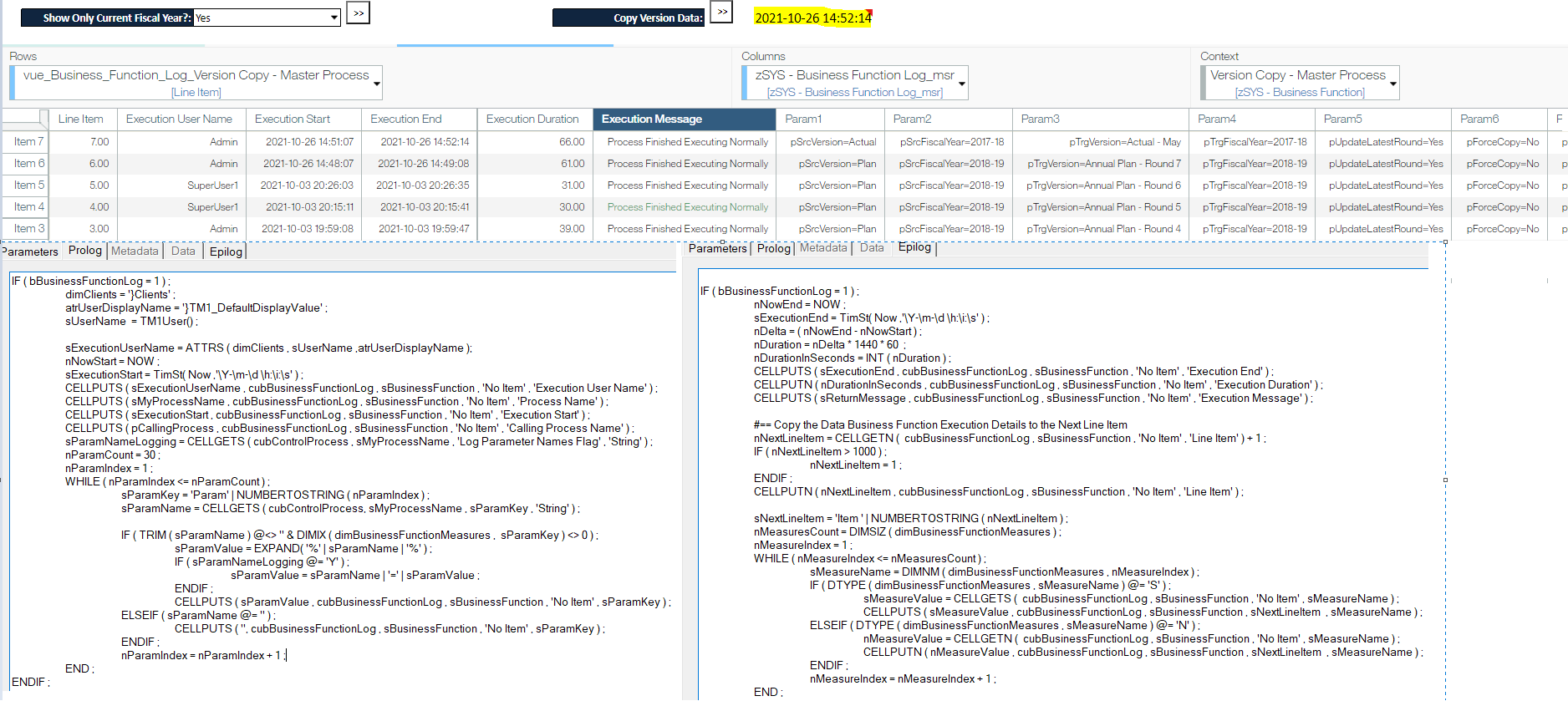

In the User Interfaces (Websheets) I show the Last Execution Time Stamp, and I have established Dill Rules and Drill Processes to show the User the details of each execution:
User Action Logging Data.PNG (163.15 KiB) Viewed 202263 times
