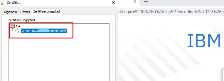

Regarding the certificate, for Cognos I have CA root Certificate(from IBM) under which my selfsigned certificate present. Attached the screenshot for the same. The request is via Gataway. url: https://win2016ca.domainname.local:9300/bi/
Is there any other way to configure the selfsigned certificate for cognos without CA root? So that problem can be fixed I think?

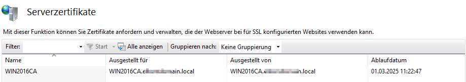

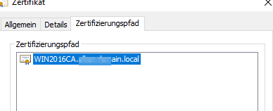

In IIS I have imported only my 'selfsigned certificate' under the 'Server Certificate'.
The certticate shown in the picture is Cognos via IIS. Url: https://win2016ca.domainname.local:443/bi/
This could be one of the reason 'the certificate conflict' via IIS not working for Architect and tm1web.

I believe the certificates are the problem given what you've just shared, and it might be this
https://www.ibm.com/support/pages/confi ... te-ca-side
If Sso is working on it's own and the bi_interop files are in the right place it shouldn't be iis related. If in doubt though you can trace the url links with fiddler to see where it is becoming unstuck.
