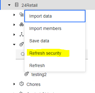

Re: What do IBM still have to do to replace Perspectives with PAW and PAX
Refresh security, isn't that just a right-mouse button click on the server name ?
Post by John Hammond »
Wim Gielis wrote: Thu Feb 24, 2022 8:32 pm Hi,
Wim, I stand corrected.

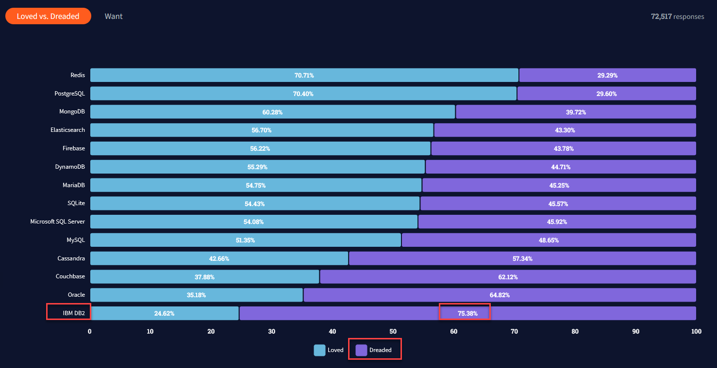

I cannot help but agree that Server V12 is not very much anticipated these days. Not because of the server itself - I'm sure that the server team will do its usual exceptional work - but if PAW is testament to IBM's ability to deploy in a containerised environment, then in my view anyone who's thinking of deploying that train wreck on prem - ESPECIALLY in a Windows environment - is likely to think that they have taken up residence in one of the inner suburbs of Hell in a west facing apartment with no blinds.
That and the fact that they are tossing out all of the advantages of traditional TM1 - a quick to deploy, robust, powerful and flexible solution that does one set of things well - and Borging the product into a collective hive of IBM's absolutely sh1t products that barely anybody needs or wants. (I suppose that I should say that the aforementioned description is merely my genuinely held personal opinion. I leave it to others to interview someone who has used Lotus Notes, or who wants to look at IBM's whopping 4% of cloud revenue (behind AWS at 33%, Azure at 21%, Google at 10% and Alibaba at 6%) and wonder... gee, why so low?)
Like Watson! From the company that couldn't even get medical imaging right - medical imaging, FFS, one of the most AI-friendly fields of endeavour - and IBM flushed billions of dollars into it, still couldn't get it to work, and flogged it off. But hey, don't worry, the remainder of Watson will deliver you Great! Performance! Insights!, trust us! And we can store all of our data in DB2, which had one of the highest rankings in the last Stack Overflow developer Survey. For one metric, anyway.
So yes, I can see NextGen sales doing really, really well. I can see it being a huge success. And yes, I have a PhD in sarcasm. But these are different conversations.

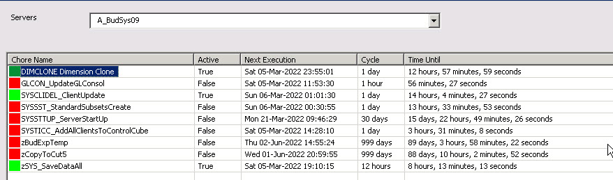

Wim Gielis wrote: Fri Mar 04, 2022 11:47 pm In Architect we can see what chores are active (scheduled) or not.
in PAW the icon is the same, regardless of that property. Not very useful.
Or do I miss something ?
1 is on, 1 is off:
This doesn't surprise me.
Let's not forget that IBM screwed THAT in Perspectives in its own inimitable, cack-handed way which utterly fails to understand end user usage of the product too.
In 9.5 we had chore icons which were differently coloured to have the active chores stand out from the inactive ones like dogs'... er, tongues.
By PA2... actually from memory this may have come in in 10.1... someone who presumably has a "Fresh! New! Look!" style fetish and no discernible UX skills that I can detect changed that to... this:
Oh yes, it's REEEEEAAAALLLY easy to discern those two icons on a very high resolution screen.
So if you're correct, and I don't doubt that you are, the PAW icons would just be the natural evolution of this. It would be another reflection of the "quality" of the products that the IBM client software group are producing.
In the meantime, and in response to the change in version 10, I created THIS with some VBA code and the classic API:
And gee lookie... I know which chores are active at a glance. I know when they will next run. I know how long until they run. And this was with VBA and the clunky ancient API so my question to you, IBM, is this... Is. It. Really. So. F***ING. HARD for you to provide useful client software?
I'm guessing that's a "yes".
