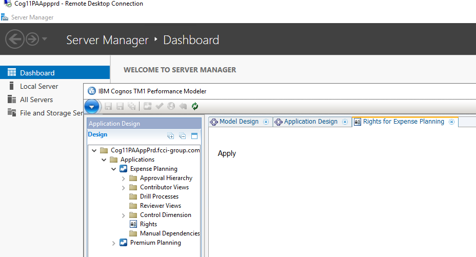

I am attempting to access the Rights under the Application Design with Performance Modeler. Instead of being able to view the rights and make revisions like I have done in the past, I see what is in the attachment. Please advise what I should do in order to view this as I have in the past.
Thank you!
Brian

Are you on an older version of the software? I was asking as I didn't think anybody still used Performance Modeler?

Did it work before on your PM? Does it work on another PM?
Try to edit rights in TM1 Applications (my.server.com:9510/pmpsvc). If there is an error, the logs in webapps/pmpsvc/logs folder should be more informative.
Also, check you }tp_tasks_appGUID dimension. It should be equal to your approval dimension.
