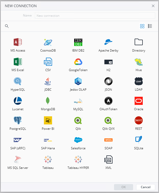

Alan Kirk wrote: Mon Jan 31, 2022 9:22 am To me, it's that TM1 really hasn't kept up with the times in terms of its range of data sources. All you get out of the box is the meat and 'taters platter of flat files and ODBC. I mean cheezez, you can't even use another server as a data source easily. Forget about JSON or XML or web page DOMs or... Granted, I am currently using an ODBC connection to Google Big Query to pull data from that, but Big Query offers SQL style data pulls which is not always the case with cloud based resources. There is still a LOT of data connection that you just can't do natively in TM1 without stepping outside and having a long conversation with Mr. Python and the API.
Since you mentioned Jedox, in terms of connectivity and data sources, what we get is night and day compared to Jedox.
Jedox connectivity.PNG (45.66 KiB) Viewed 24783 times
