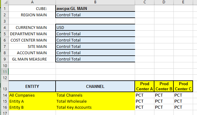

I am attaching a screenshot that I hope should provide a some more context into my challenge. The fields in rows 1-9 remain constant for every calculation in the spreadsheet. However, the cells highlighted in yellow can change for every row/column. What I am trying to avoid is replicating the below formula for all 800+ calculations.
Calc001 = A \ B;
CELLPUTSN('Product Allocation Cube', 'Calc001', 'dim1', 'dim2', 'dim3');
If I am understanding it correctly, It sounds like your recommendation would be to create a third cube and create an Allocation Flag for Entity, Channel and Product Center. Then, in the "A" portion of the formula above, I would write the following:
Value = CELLGETN('GL MAIN', 'Actual', 'Control Total', ATTRS ( 'ENTITY MAIN', !ENTITY MAIN, 'ALLOCATION FLAG' ) @= 'Y', 'USD', 'Control Total', 'Control Total', ATTRS ( 'CHANNEL MAIN', !CHANNEL MAIN, 'ALLOCATION FLAG' ) @= 'Y', ATTRS ( 'PRODUCT CENTER MAIN', !PRODUCT CENTER MAIN, 'ALLOCATION FLAG' ) @= 'Y', 'Control Total', 'Control Total', '!PERIOD MAIN', 'Total') \ B;
CELLPUTSN('Product Allocation Cube', ' Value ', 'dim1', 'dim2', 'dim3');
Am I on the right track?
