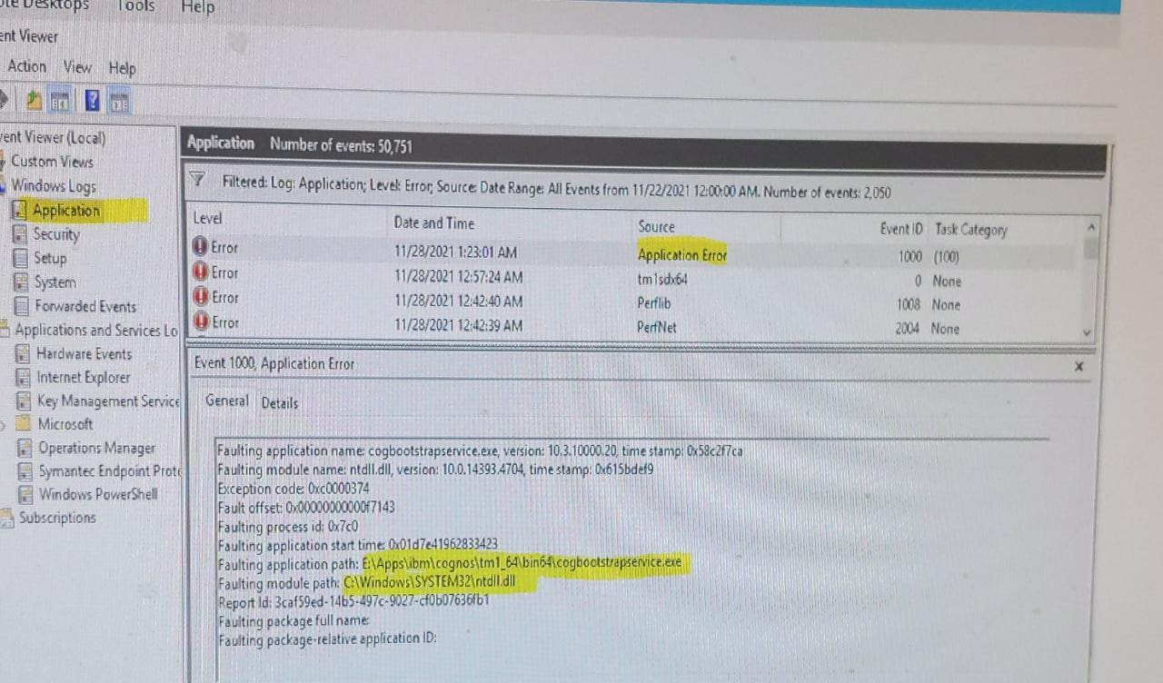

I can see that in the services as "IBM Cognos PA" is running state that I restarted the "IBM Cognos PA" from "IBM Cognos TM1 Services" from IBM Cognos configuration component. while restarting that I never faced any issues with TM1 web services. I see some application related application logs from the windows logs (Pls see attached print screen).

we have planning analytics 2.0.2 but also i am checking tm1sd.exe file properties, the version 11.1.00000.30.

Firstly, I think those two error messages in event viewer arethe result of crashing the application, aka stopping the tm1 application by clicking end task/process,. When you stop the service in such a manor the tm1s.log can become corrupted, out of sync preventing the application from starting until it is deleted. It is advisable to wait for the service to stop itself, rather than forcing it. It could take a while depending if there are locks in progress and a lot of data has changed since the last savedata was executed.
