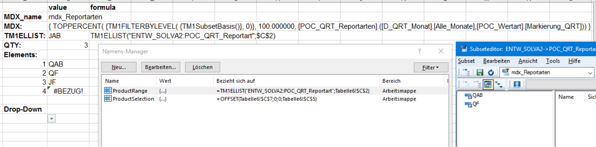

Here is what I did so far:
  • 1. disabled auto refresh
  • 2. Created named range with TM1ELLIST formula as reference (the formula is only working, when I am using the name of the MDX (mdx_Reportarten)
    and not when I am pasting the whole formula from the subset editor into Excel
  • 3. I used "ROWS" to count length of the named range (here I got back 1 at first, which makes no sense. After a while (like 30 min.) a 3 appeared. 3 whatsoever is the number of the elements in the mdx subset before I changed the definition. Now it should display 2, as you can see in the provided
    subseteditor below
  • 4. Same goes for the results of INDEX, which display still 3 elements instead of 2
  • 5. Created another named range (ProductSelection) using OFFSET as indicated to retrieve the
  • 6. Referencing ProductSelection (list, source: =ProductSelection) I get some undefined source error and data validation drop down stays empty
How can I work out this issues?
Best Regards
Leonhard Geisler

LGEIS wrote: ↑Wed Nov 17, 2021 3:27 pm
Hello, I may misunderstand something... You need to enable autorefresh. Without it, you will not be able to use dynamic drop-downs
