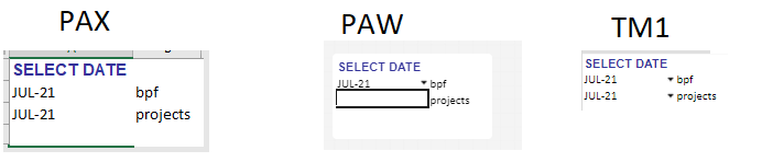

by M1ndbender
ok I got somewhere but am a bit confused. I created a sheet in PAX with 2 subnms. One pointing to one dimension and the other referencing the other.
It works in PAX and in TM1 but when I add it to PAQ as a websheet the second subnm does not populate. The visualizations connected to the primary dimension refresh perfectly from the websheet but the others based off of the second dimension still do not refresh.
Any thoughts on what I might have done wrong to make the second subnm now show in PAW? I attached an image of what the websheet looks like in PAW and PAX
