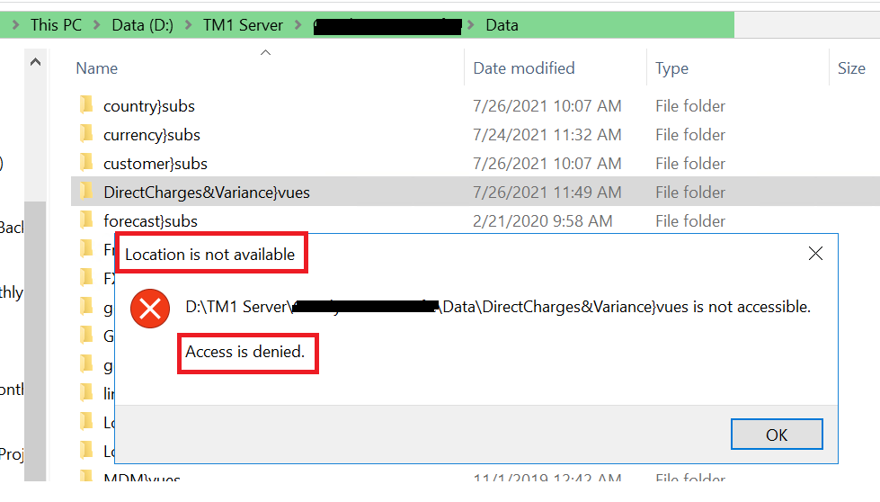

Upon checking the DATA DIRECTORY, found that subset / View folder doesnt exist there but is visible (Check the screenshot attached)
To fix this I have to RESTART my TM1 Instance, but I cant Restart the server everytime.
How to fix this ?

Yes I am trying to DELETE the }vues Folder while TM1 Server is running
I cant even open this PARTICULAR folder as of now, while in other files/folders (under data directory) I dont have any issues even when server is running
I feel this vues folder is got created by some process (and all vues already got cleared in Epilog section) but this folder still virtually remains, hence not able to delete/open.

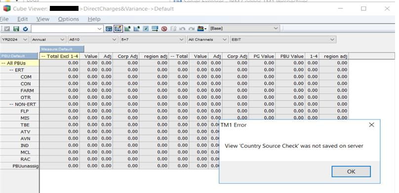

bt in few cubes (for views) and in few dimensions (for subsets) we get below mentioned error
Reason same as mentioned in main post.
Subset/View folder doesnt exists in server but is visible and we are not able to delete that too manually. (only with Server restart we can do that)
TM1 View Error.png (297.15 KiB) Viewed 6814 times

I have seen this when a views folder contains .xbv views (MDX created e.g. through ViewCreateByMDX or PAW views etc.)
If you manually delete the views folder while the server is still running there is a disconnect where TM1 gets confused by thinking that the folder already exists, so it tries to save a view in the folder that isn't actually there.
I don't think I've seen it how you have where the folder is actually visible, but from the error message when you try to delete it - you can tell windows has a problem with the folder not REALLY existing.
Either way long story short, do not delete any subfolders in the data directory while the TM1 service is running.
TM1 will on its own delete a view folder if you delete all the views in it (using the GUI) - but I must be honest that I have seen it fail to do this sometimes.
But any cleanup maintenance etc that is required should be done on a stopped service otherwise you will likely run into issues.
