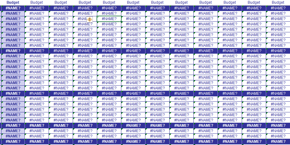

I was recently given access to PAX but in every view I open every field shows #NAME? and I noticed all of the formulas now start with @.
I did read that the @ was a new piece of MS Office and should cause no issues.
Has anybody else had this issue and could help me out?

Normally the name reference is because you don't have the Excel add-in activated.
The COM Add-in runs the ribbon etc.
But to get TM1 formulas to work you also need the Excel Add-in called "IBM Cognos Office Reporting TM1 Addin" - you can activate it with the CognosOfficeTM1.xll file if it's not already available to tick for you.

Re: PAX always showing #NAME Error?
Thank you for the help. I am pretty sure that worked. I get all #VALUE? errors now but I think that is my connectivity being unstable.
Thank you for the help. I appreciate it
