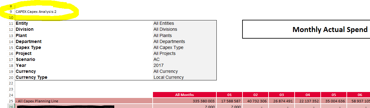

This is what it looks like locally on my PC:
Easy enough, 1 cube, nothing but plain selections with SUBNM and values with DBRW. Hardcoded server name CAPEX into these formulas as well as in TM1RPTROW, TM1RPTVIEW, etc.

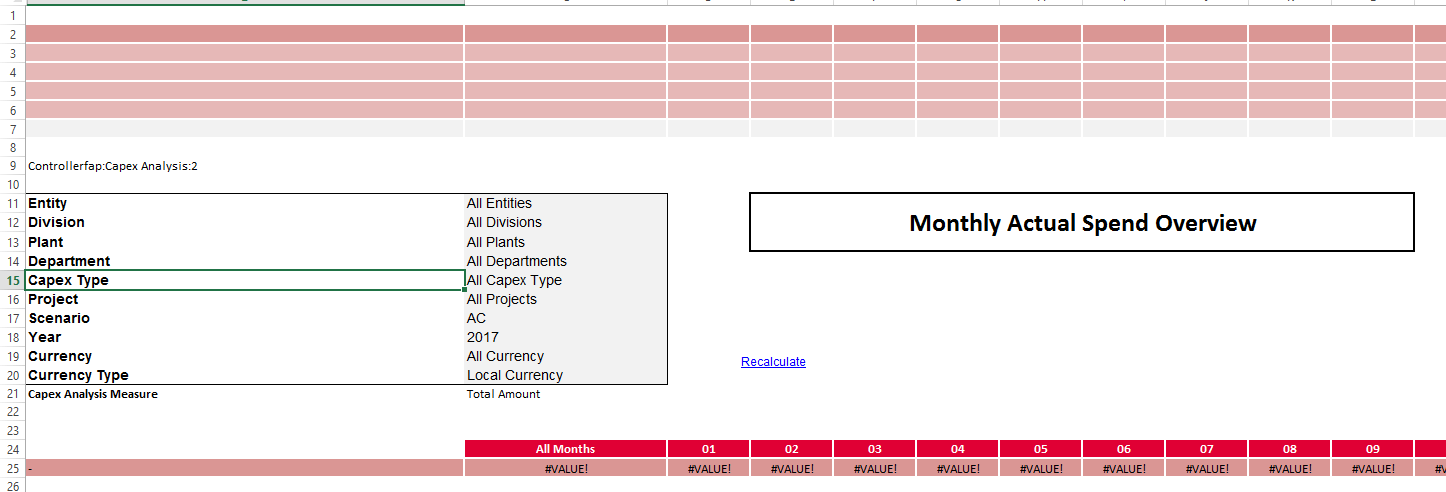

This is what it looks like in PAFE on the server, with model name B:
Hardcoded server name for B with find/replace. All references are fine, subsets exist, and so on.
What am I missing here ? Don't tell me I cannot find/replace (hardcoded) server names to have the reports available in a different TM1 model... and that I would need to rebuild many many reports with active forms... :oops:

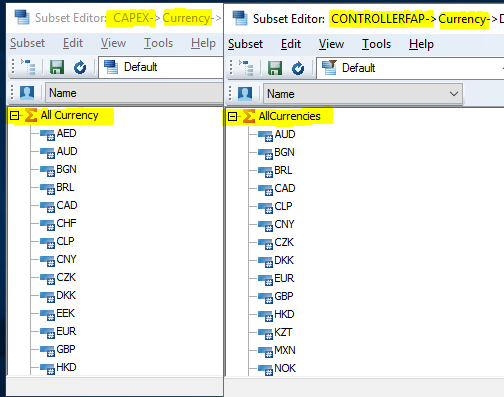

The reason is a change in element names:

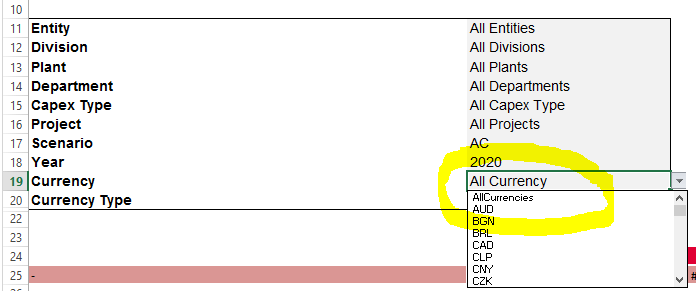

While the SUBNM's give a dropdown list but still show the element name from the other TM1 server:
