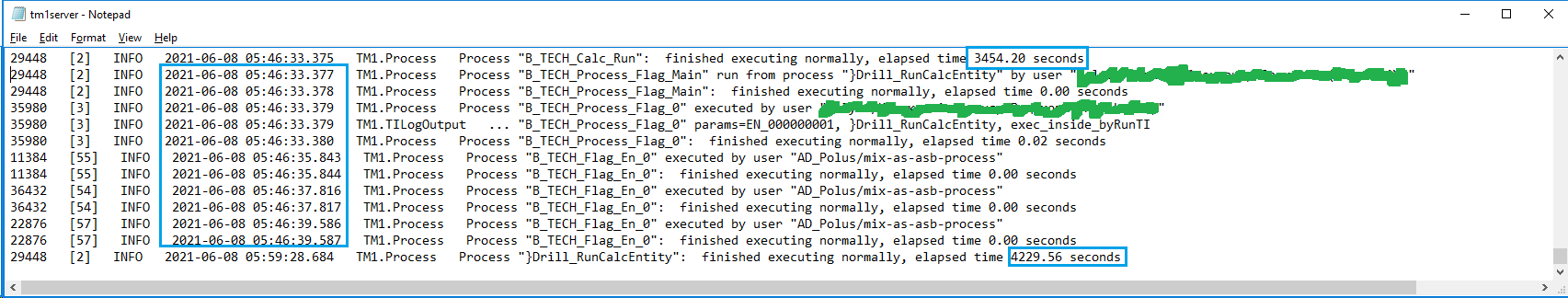

I have few processes nested in another TI.
When nested processes have finished main process is still running for a long time (about 1/5 of total process time). And it is not "Commit".
After execution of nested processes there are no actions except for recording statistics in main process.
All this time (between finished nested processes and the main one) in TM1Top "ObjectType" column is displayed "DimensionSubsetMap" and there is no any information in tm1server log.
Has anyone faced a similar problem?

Hi, Elessar. Thanks for your recommendations.
Process and sub-processes don't update dimensions at all.
Main process has one long-time working subprocess with another subprocess (about 7/10 of total time) with difficult and multi-iterative calculations. If I'll comment this sub-process then of course the problem will gone (I've tried it), but I won't get a results of calculation
This is not classic drill through command, but the way to start TI process from Architect form

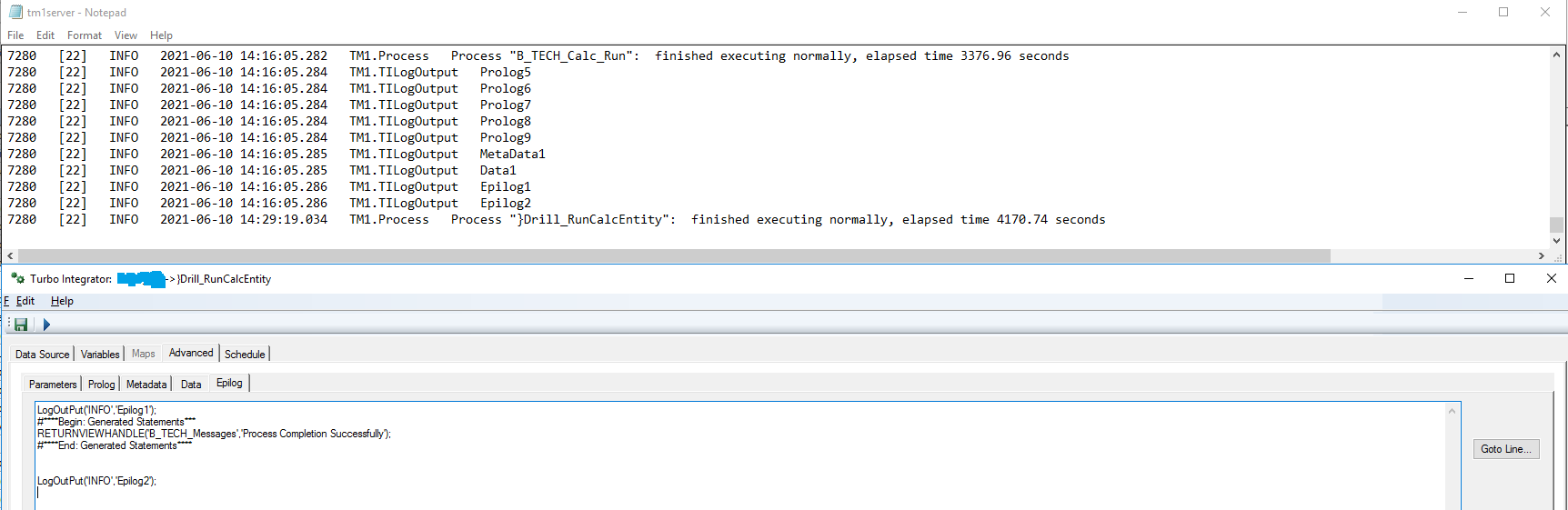

Re: Long time execution of TI after finished nested processes
It doesn't matter. I commented all of process execution after line with execution long-working sub-process - issue hasn't gone.
Do you mean log4j.logger.TM1.Lock=DEBUG parameter?
I tried to do it, but i didn't notice anything unusual there.
It is a good idea, thanks.
But as I expected, the time for an unknown action begins after all lines of the main process.
As I said earlier all this time in TM1Top "ObjectType" column is displayed "DimensionSubsetMap". Perhaps it relates to creation of a large number of views and subsets during process (I use temporary views and subsets)?
- example2.png (47.3 KiB) Viewed 10689 times
