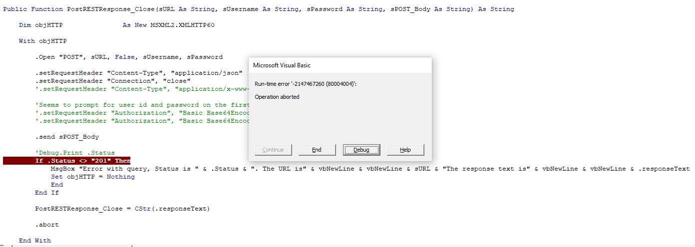

Thanks ! In fact, the code stops with an error:
I don't know what to supply in the Body for the Post command (the logout).
Supplying an empty string does not work. Leaving out the sPOST_Body argument gives an error too.
In Postman I have the impression (based on TM1 samples and they work) that we don't have to provide a Body. In VBA though it seems to expect at least something but I could br wrong here.

Hi Wim,
Came across this post and the error recently.
The errors is basically saying that the call has not finished processing yet and the status is not available.
If you change the Asynch flag on the .Open to True it should behave differently, or introduce a slight delay.
HTH if you have not already solved it and forgotten about this.
