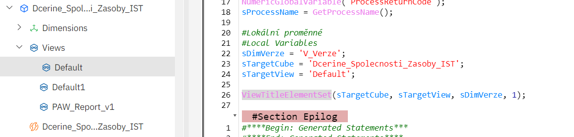

Hi, I am attempting to run simple TI process with ViewTitleElementSet. I created the view Default as seen in the pic, but when i try to run it I get an error msg: Error: Prolog procedure line (26): View "Default" in cube "<2>" not found. When I swith to Default1 it works fine. Any ide what might be causing this? Thanks

You can open up the view manually without issue ?
What is the result of the ViewExists function on that cube and view ? 1 ?

Hi, Yes I can open it, ViewExists returns 1

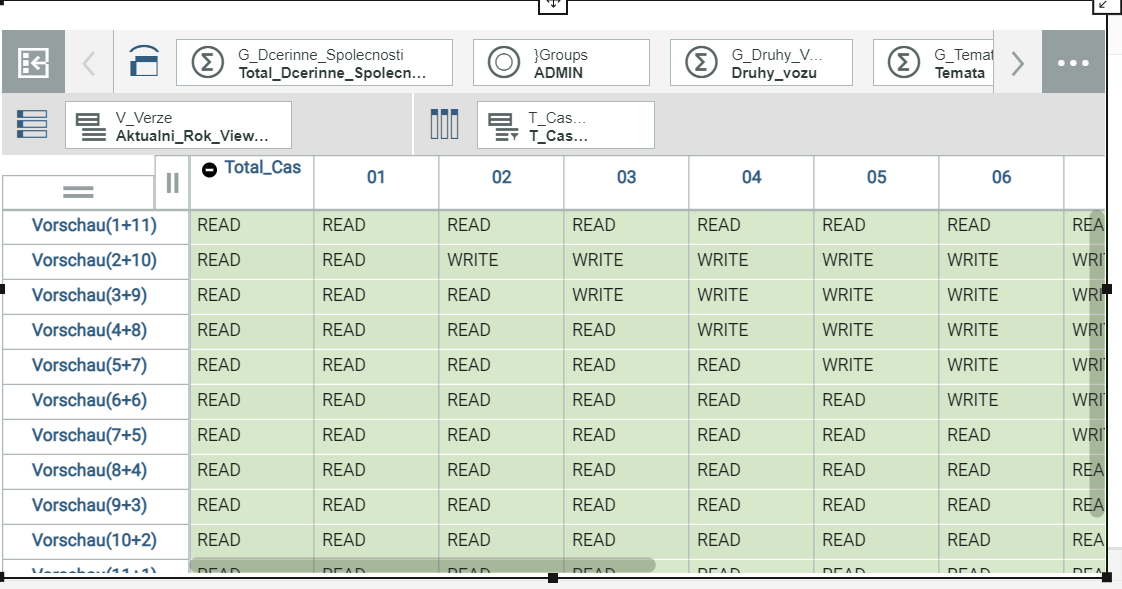

Thore is a cell security (see emg), I am an admin and cant run it. The layout is 7 dimensions:
G_Dcerinne_Spolecnosti on Rows,
T_CasM - Columns
G_Druhy_Vozu
G_Temata
G_Zavod
V_Verze
M_Dcerine_SPolecnosti_Zasoby_IST
There are 3 dynamic subsets: G_Dcerinne_Spolecnosti, T_CasM, V_Verze
