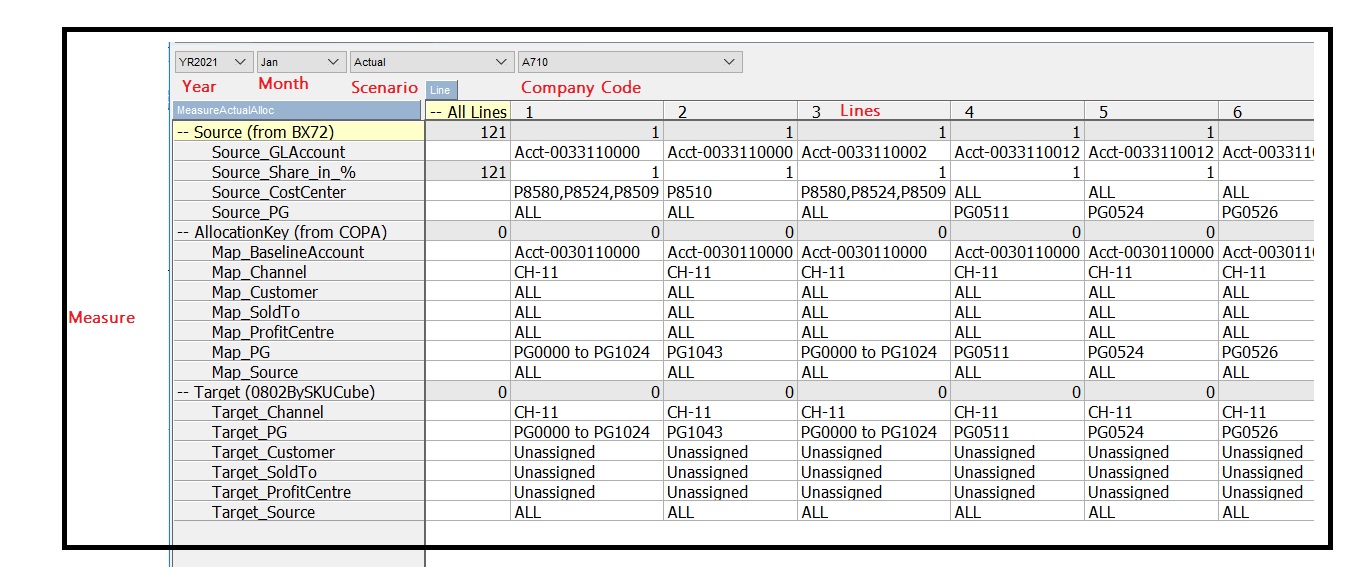

I have a cube (view screenshot attached below)
I have exported the data in a csv file, using following code
To remove the duplicates in extracted file I tried to make sure to select All consolidated level data in PROLOG tab,
But I have no option for MEASURE DImension, as consolidated level data is 0 in most of the parent elements.
Below is my

Getting few DUPLICATE Records, hence was thinking to create another SUB TI inside this to remove the duplicate records
Please guide me on how to change the SOURCE VIEW or DATA TAB code to get all UNIQUE records as OUTPUT
Many Thanks in Advance.
My actual issue is
- TM1 Cube View
- TM1 Cube View.jpg (264.03 KiB) Viewed 6408 times
Re: Source file having duplicate records, need to remove them through a TI process
What is the definition of unique / duplicate records?
What is the expected outcome and what records should not be exported based on the screenshot ?
