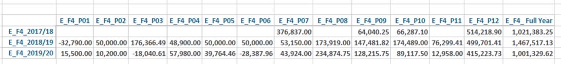

I have updated my Month Dimension Generator to include a Period Totals Named Hierarchy. This includes consolidations giving the sum of the same period across all years, and a Full Year consolidation of those periods. With this, in PAX or PAW you can use, for example, the Periods and Full Year subset on the F4_Per_Tot Named Hierarchy on the Columns and the Year level of the F4_YHQM Named hierarchy on the Rows. (The F4 prefix means that the Financial Year starts in April, since obviously what is considered Period P01 is different if the company uses eg the Calendar Year as its Financial Year. The generator allows you to generate dimensions that include the Calendar Year and Financial Year(s) starting in any period you want.
It is free to download via our web site [url]http:www.successcubed.co.uk[/url]
I would hope that this finally puts the one or two time dimension debate to rest, but I doubt it.
Paul Simon
Paul Simon
