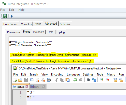

Who can explain the below result ? The text file is the one generated by the TI process.

I can't access TM1 at the moment, but my best guess would be either:Wim Gielis wrote: ↑Fri Apr 09, 2021 8:14 pm Who can explain the below result ? The text file is the one generated by the TI process.
(a) A new dimension that has been registered in memory, but the system hasn't updated the control dimension yet (or it has updated a copy but hasn't committed it, in the way that dims are updated in the classic API); or the other way around
(b) A deleted dimension that has been removed from the control dimension, but hasn't been released from memory yet. We know that TM1 is something of a memory hoarder with garbage memory.
Unfortunately I can't test this at the moment, but those are the only things that make sense.
Re: Does the dimension already exist ?
Hi Alan,
I can reproduce it with restarting the model, the entire laptop, ...
In fact, I know what is the reason but I thought: hmmm, maybe my Dimix() test isn't so fool-proof.
What we observe is valid and correctly working functionality that can be used in a TM1 model, which leads to the actual behavior.
Which is not to say that your reasons cannot lead to the same behavior of course.
You know that you haven't actually said "what the reason is" there?Wim Gielis wrote: ↑Fri Apr 09, 2021 8:47 pm In fact, I know what is the reason but I thought: hmmm, maybe my Dimix() test isn't so fool-proof.
Well, I had to search for it couple of minutes, to understand what was going on. But yes, I found the / one of the reasons
You also pointed out other plausible reasons. I wanted to see what others would think and to stress that for example DimensionExists is safer than Dimix to the }Clients dimension.

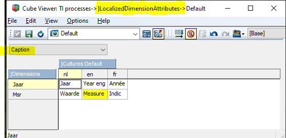

If a TM1 model needs to be made multi-language, it can be done with a Caption:
Cubes, dimensions, elements, views, subsets, processes, chores, ... can be made multi-language.
Too bad this does not work !
It gives back 'Measure' instead of Msr.
DimensionElementPrincipalName( '}Clients', 'Measure' )Best regards,
Aaaah, I see!Wim Gielis wrote: ↑Fri Apr 09, 2021 9:39 pm If a TM1 model needs to be made multi-language, it can be done with a Caption:
That's kind of an "edge case" for most users (Swiss and Canadians being the most likely exceptions), but still very useful to know.
Have not used the multi-language functionality (Southern English, aka: The Way God Himself Talks, is avoided in my naming conventions to avoid things like whirly-gig processes, hog waller cubes, shotgun dimensions, etc.).Wim Gielis wrote: ↑Fri Apr 09, 2021 8:14 pm Who can explain the below result ? The text file is the one generated by the TI process.
However, is it because the caption is defined as text, not an alias?

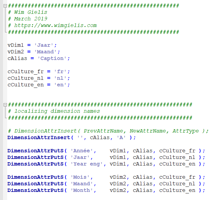

Hello Ty,
While not definitive proof, I am almost certain Caption is an Alias here. I found back this part in a TI process of some time back:
