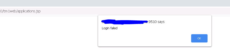

Error in TM1Web that appears after successful authentication.

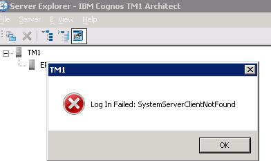

Error in Architect that appears after successful authentication.

I'm assuming TM1 config has been updated to reference cognos analytics with https in the address.
Do you have Planning Analytics and Cognos Analytics installed on different servers? Are you using a certificate from a CA authority or a self-certified certificate.
It could be that the Planning Analytics server doesn't trust the CA certificate, can happen if you're using a self certified certificate. Do a search for "manage computer certificates" from there you can import the cognos analytics certificate into the trusted root section.
If you're still unsure of the cause try using a tool like fiddler which can trace network traffic and try accessing the website through a browser.
Also if planning analytics has just been updated to ssl don't forget to update the bi_interop files that are put in the Cognos Analytics gateway so they are also pointing to planning analytics under https as opposed to http
