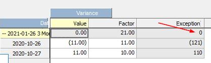

I'm not sure what you are expecting here. The highlighted cell is not going to suppress from a column perspective because there are values for other rows in the same column and it's not going to suppress from a row perspective because there are values for other columns in the same row. That's how zero suppression works in TM1. Were you expecting something else?

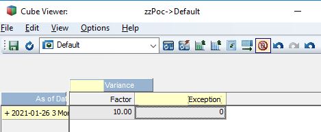

Hello Tomok,
I was showing it expanded for clarity.
When the Period dimension is collapsed to only show Consolidation. It is not suppressing the exception column.
See collapsed screenshot.

What is the format of that 'Exception' cell ? If you right click on the cell and select 'Trace Calculation...' what do you see ?

Trace Calculation shows 0.
I tested it out by slicing it to excel and divided a value by the exception to prove it to myself that it is indeed a zero as I got #DIV/0!

You still see the 0 on the consolidation element because you try to override a consolidation with rules. The zero-suppression will not make that intersection disappear because if there was no rules on C: level, the value would not be 0. I guess that's how TM1 works !

Emixam wrote: ↑Thu Feb 25, 2021 8:53 pm I guess that's how TM1 works !
Yes, exactly:
  1. Calculate consolidations
  2. Suppress zeroes
  3. Override consolidation value with C: formula
If you have at least one fed/input cell in consolidation's children, it will not be suppressed with zero suppression.
