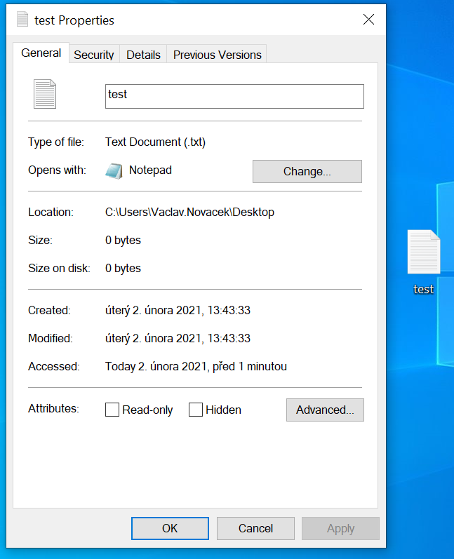

I am attempting to export random value in range 1-6 into txt file on desktop. I am getting File not found error message. Any idea what might be wrong here? Thanks.

TI executes the process on the server, while you might be referring to the desktop on your PC. Is that the case ?

Hi, thanks for the reply. I beleave so.
Re: Exporting random values in range 1-6 to txt
Then you know the answer, the remote server does not know your own PC.

Damn. Thanks for the answer.
