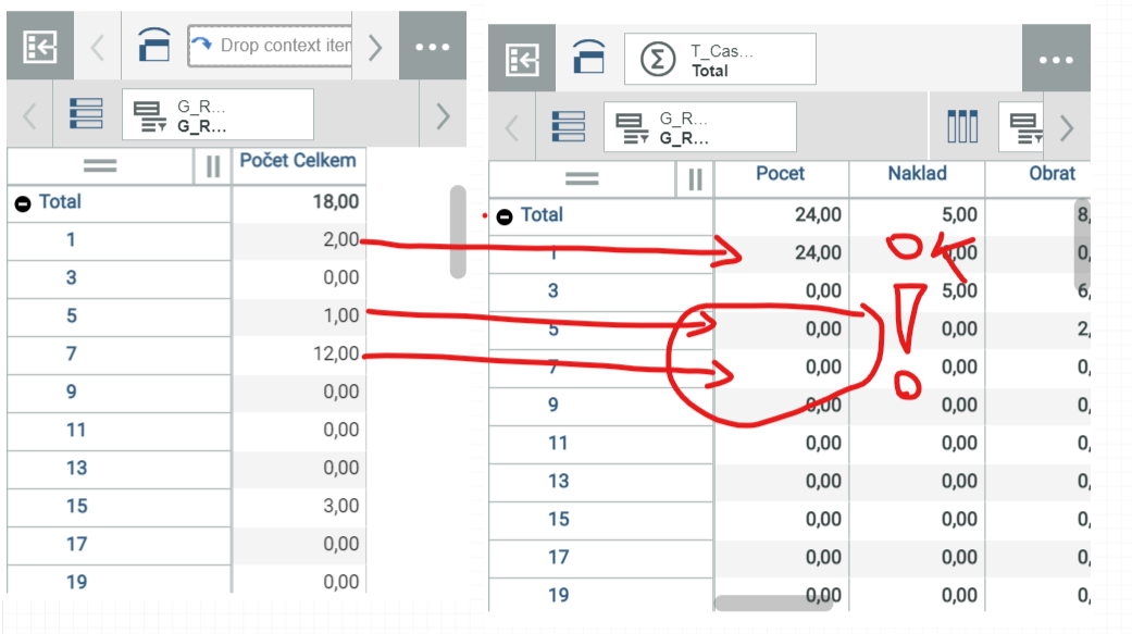

Thanks for the advice. I used the while version. It worked - sadly only for the first row (viz. img 1). Any advice on what went wrong and how to fix it? Thanks

You need to reset the counter (LoopCounter = 1) before "While" in Data tab.

Thanks a lot
, fixed it:
While(LoopCounter2 <= G_Rada_Size);
LoopCounter = 1;
WHILE(LoopCounter <=12);
ElName = NumberToString(LoopCounter);
CellPutN(Value, sTargetCube, G_Rada, ElName, 'Pocet');
LoopCounter = LoopCounter + 1;
END;
LoopCounter2 = LoopCounter2 + 1;
end;-
