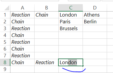

The way I understand the requirement is that a column (in Excel) contains cells with text contents. If, in the absence of empty cells, someone types the start of an existing entry, Excel will complete/suggest the rest of the contents. Only when the first part of the cell contents is unique.
There is no AI type of wizardry in Excel.
And it only works within the same colum.
Re: Tm1web string data entry autofill

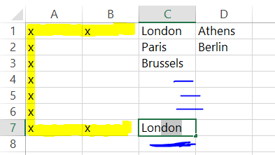

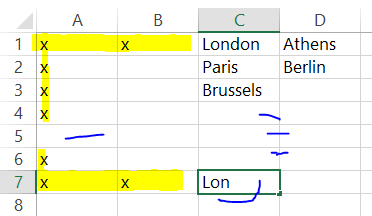

One would think it does not work when empty cells exist in the column:
HOWEVER there is a trick :o Have you ever seen this one before ? Let's create a trail......
Now that's what I call Excel trickery... :lol: :D
Break the chain and it stops working:
You can create the chain in a hidden column. But better yet, AVOID EMPTY CELLS AT ALL COST !
If you don't like the x any character is fine :)

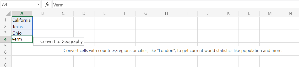

I'm not talking about autofill (which exists yes since forever). Or even about flash fill (which is a little new and funky, and even, dare I say it, a bit A.I.ish). But about the new "data types" feature (which does work pretty well for things like geography). Using the geography data type entries can be auto-completed for items which don't already exist in the list above (and aren't predefined in a data validation), but it can also do other more funky stuff like below.

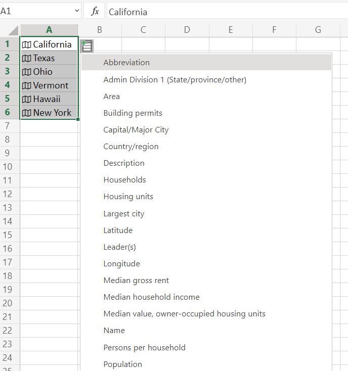

E.g. Excel recognizes a list might be geographic in nature ...

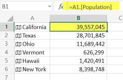

Which then allows the user to access properties of the data category ...
Via table lookup of power query like formulas ...
Now maybe I am a little more easily impressed than you but IMO this is quite funky.

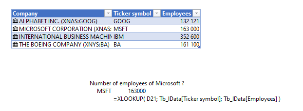

I know about FlashFill and the new data types: geography, stocks, and many more that are coming towards Excel (chemistry, movies, ... and also your own data types like Customer or Product). I gave a presentation last December about Excel, what it currently is and what the near future will bring.
For example, lookup of a Stock data type Ticker symbol (of Microsoft) to retrieve its number of employees:
