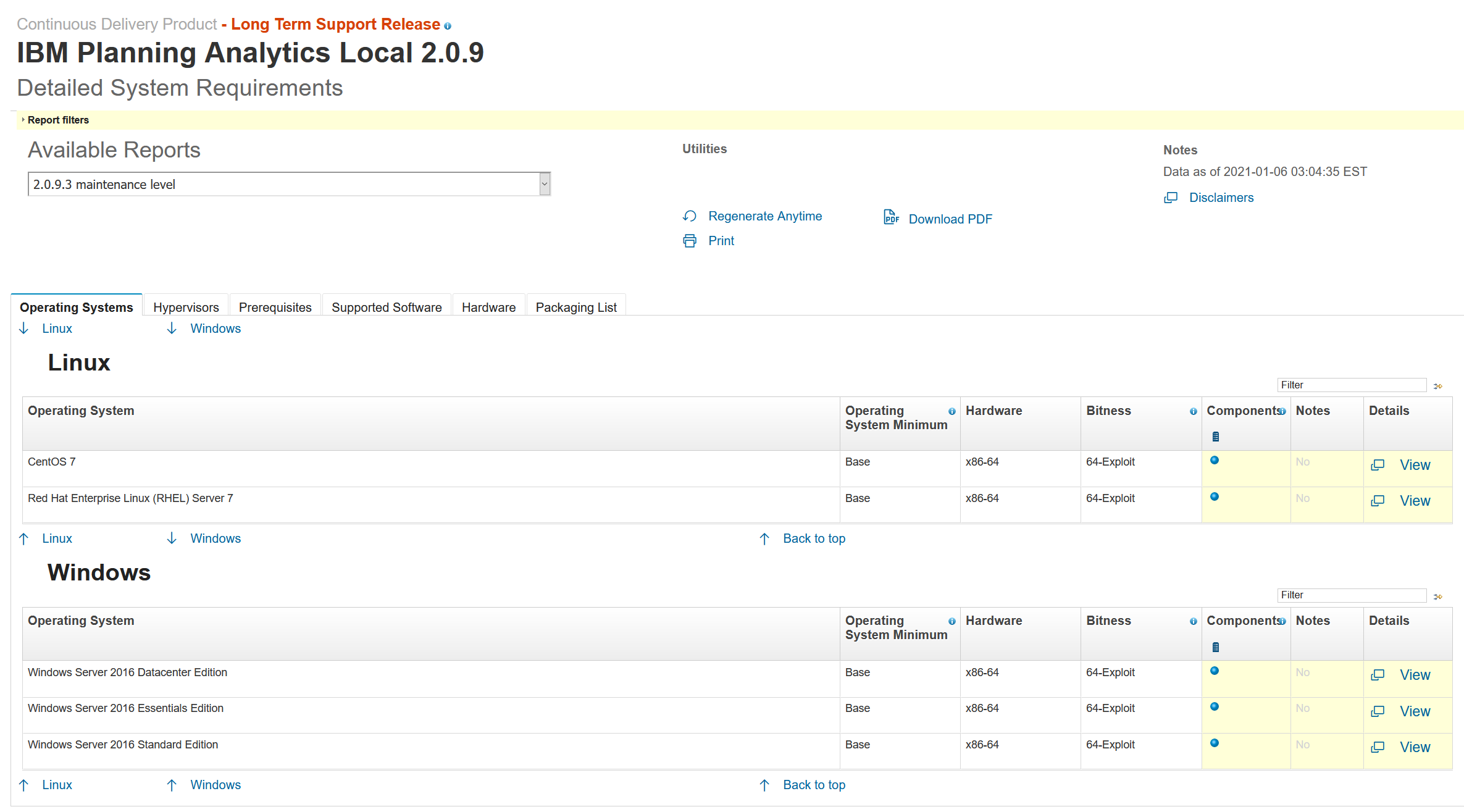

Oh, and thanks for the pointer, George. I should have added; I know that the thread that you pointed to was from late 2019, but according to the Software Compatibility Tool (I selected PAW specifically, though to see that you need to click on the View link) this is still the case:
- PA2Support.png (199.1 KiB) Viewed 19593 times
