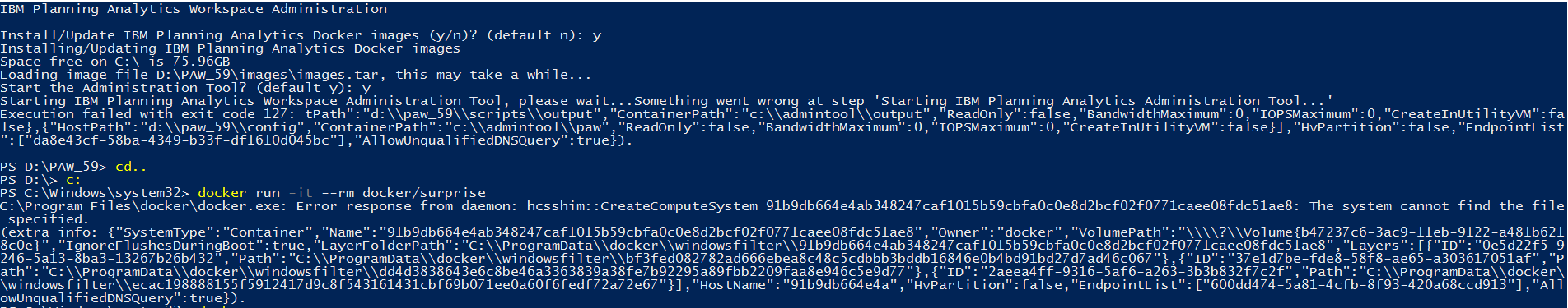

While upgrading PAW 2.0.59, i found attached error on windows 2016 server.
When i clean up using " .\WindowsContainerNetworking-LoggingAndCleanupAide.ps1 -Cleanup -ForceDeleteAllSwitches" then run docker surprise function to check docker health then it work. I was able to create services using (./paw.ps1). When i tried to start admin tool, attached error come out. Moreover, docker surprise command fail again.
anyone found this or similar error? please assist here to identify the root cause.
Please Advise.
