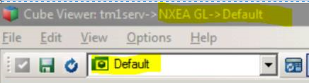

In perspective, a default view is created by Admin saved with all dimensions set at default subset.
When a user click on those dimensions, it doesnt show the default subset.
I had always assumed the default view if saved with default subsets by Admin would show default subsets to users.
Is this not the case?

Does the user have a private default view? If so, this will take precedence.
Paul

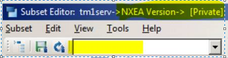

No, it looks like user is looking at public default view. see attachment. but when clicking dimension,subset is not (2nd attachment)

According to your pictures the subset used in the public view is indeed private. This is an invalid combination which is why other users are not seeing your private subset when opening the view.

Hi, That is what the users see when they click on the subset. The administrators view is both public
