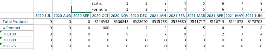

Hi, Curious to see if anyone else is experiencing the same issue or having the same problem with DBRW formulas being overwritten in dynamic reports when copying and pasting.
I am trying to mimic how some users will be sending data to TM1 based on their own workings that they may have in various workbooks. Typically they would copy and paste into the template.
The image below shows a very simple dynamic report with a few products on rows and months on the columns with a full year on the end. Formulas are straight DBRW's no other functions, nesting etc. PAfE is 2.0.59, TM1 11.8.100.13
PAfE Formula Overwrite 01.PNG (12.51 KiB) Viewed 6186 times
The row with static is simply numbers 1 through 8. The row below has formulas referencing the cell above e.g. =J13.
If I copy and paste the static numbers into the report, I get what is shown against # Product, in the above.
If I copy and paste the formula based numbers into the report, the formulas are pasted into the report overwriting the DBRWs and thus referencing the cell above, per yellow highlights below.
Design Mode is not enabled - have toggled and re-tested a few times to be sure. Working with Automatic Calculation enabled, Custom Report - Refresh data on writeback = None.
