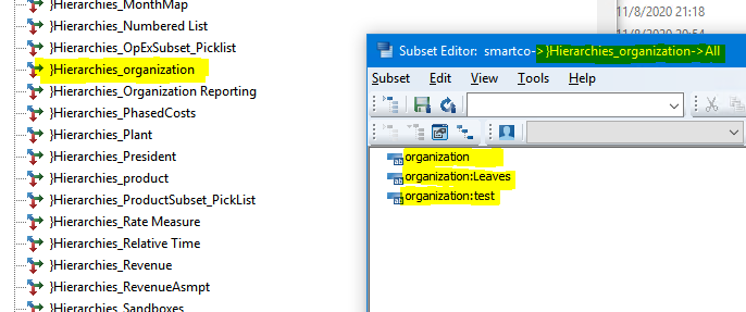

I see a dimension called }Hierarchies_organization for a dimension called organization:

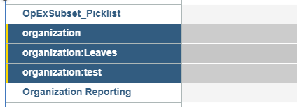

The }Dimensions dimension contains elements like this:

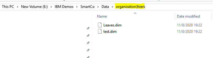

And a folder structure on the hard drive:

But this }Hierarchies_organization dimension is a really nice tip. I am gonna use it.
