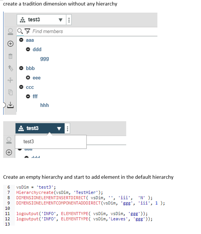

Thanks. Yes, as long as the leaf is not used in other hierarchies other than the default and leaves hierarchies, it still can be converted from N to C automatically. I actually might find a bug while playing with this when using DIRECT version of dimension functions. i.e. DIMENSIONELEMENTINSERTDIRECT or DIMENSIONELEMENTCOMPONENTADDDIRECT etc. The Leave hierarchy will be out of sync somehow. The server version I am using is "TM1SERVER_version=TM1SERVER-AW64-ML-RTM-11.8.00000.33-0"
Here are the steps.
If you could share any opinion on it, it will be great. :)
