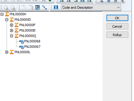

I have a multi level hierarchy in my management account dimension, as shown in Subset with hierarchy image.
1.2 Subset with hierarchy.png (17.08 KiB) Viewed 8761 times
PNL00000Q should be a calculation of ABS( PNL000068 ) - ( PNL000067). This is working okay.

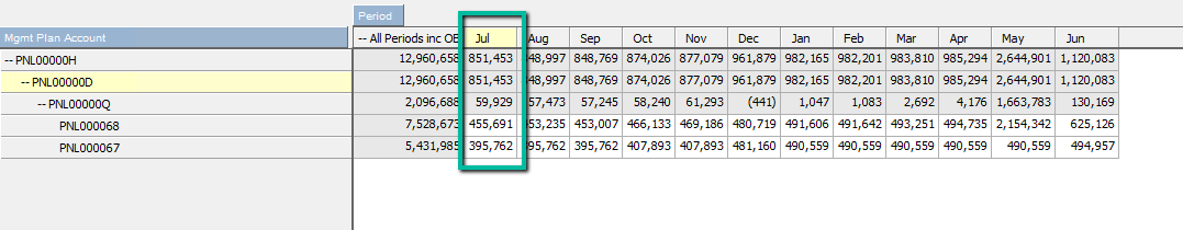

However the parents of PNL00000Q,PNL00000D and PNL00000H levels are not working correctly, both D and H levels are actually summarizing level 68 and level 67 instead of picking up value from level Q as shown in CubeView with data image.

Setting a c-level rule, as you do for PNL00000Q, does not impact higher-lever consolidations, in this case PNL00000H or PNL00000D, as those also consolidate leaf-level elements. You’ll need to use ConsolidateChildren, but this gets messy.

Easily fixed - use weightings. This will also be faster. Adam is right that c level rules do not consolidate onwards.

Although the premise around absolute values seems unusual, here's how I would go about this:
1. PNL0000067 set weight to 0.
2. PNL0000068 set weight to 0.
3. Create new element PNL0000067_ABS, place next to PNL0000067 in the hierarchy and set weight to 1.
4. Create new element PNL0000068_ABS, place next to PNL0000068 in the hierarchy and set weight to 1.
5. Add rule so PNL0000067_ABS = ABS(PNL0000067). PNL0000067 =feeds=> PNL0000067_ABS.
6. Add rule so PNL0000068_ABS = ABS(PNL0000068). PNL0000068 =feeds=> PNL0000068_ABS.
This approach will consolidate up.

I see what you mean Maren, then just:
1. PNL0000067 set weight to -1.
3. Create new element PNL0000068_ABS set weight to 1 and place next to PNL0000068 in the hierarchy.
4. Add rule so PNL0000068_ABS = ABS(PNL0000068). PNL0000068 =feeds=> PNL0000068_ABS.
