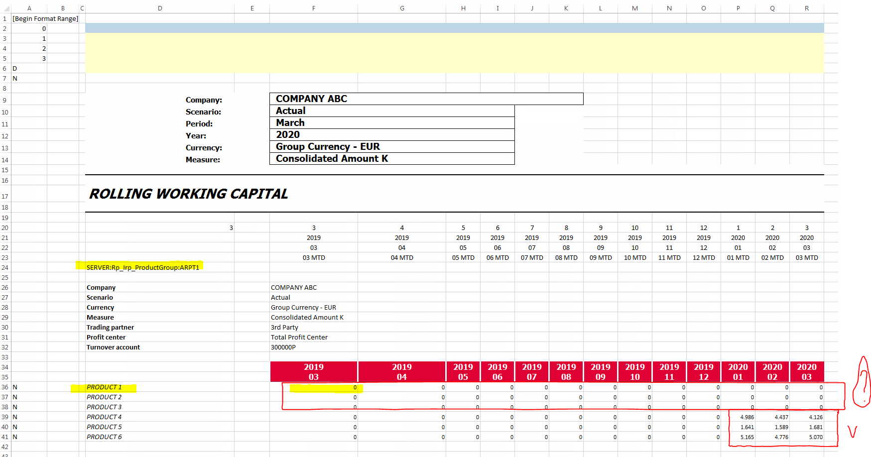

A longer post/question but I want to explain it as best as I can.
In the past I have been fighting with Active forms a lot. In fact, I still do, from time to time.
I have the Active form below, where zero suppression clearly is not working. 3 rows are correct, 3 other rows should be removed from the report. I verified in the cube that it's all 0 there. No rules calculations, it's just actuals data. The cube contains 10 dimensions, 7 of them are listed in the area D26:F32. The other 3 dimensions are Rp_Product, Rp_Year, Rp_Period. They are in rows and columns of the Active form.
The question is probably two-fold:
- what can I do to get it working ?
- if this is not possible when the Active form is already there and I need to start from scratch: what cube view layout and what dimension selections do I need to have to get it working. The year and period dimensions are separate, and the report happens to be a rolling window of 13 periods, ending with the period the user chooses. Do I need to make a total of 2019 and 2020 and put it in my cube viewer view before creating the Active form ? Select Total Year ? Select all products ?
I removed all formulas here below but I still have my main report to test any suggestions you might have.
The formula in cell D24:
=TM1RPTVIEW("SERVER:Rp_Irp_ProductGroup:ARPT1", 1, TM1RPTTITLE("SERVER:Rp_Currency",$F$28), TM1RPTTITLE("SERVER:Rp_Scenario",$F$27), TM1RPTTITLE("SERVER:Rp_ProfitCenter",$F$31), TM1RPTTITLE("SERVER:Rp_AccountTO",$F$32), TM1RPTTITLE("SERVER:Rp_Tradingpartner",$F$30), TM1RPTTITLE("SERVER:Rp_Company",$F$26), TM1RPTTITLE("SERVER:Rp_Irp_ProductGroup_Msr",$F$29),TM1RPTFMTRNG,TM1RPTFMTIDCOL)
The formula in cell D36:
=TM1RPTROW($D$24,"SERVER:Rp_ProductGroup","Inventory Products")
"Inventory Products" is a dynamic subset:
TM1Sort( TM1FilterByLevel( Descendants( [Rp_ProductGroup].[Total ProductGroup Inventory] ), 0 ), Asc )
The formula in cell F36:
=DBRW($D$24,$F$28,$F$27,F$34,F$35,$F$31,$F$32,$F$30,$D36,$F$26,$F$29)
Thanks a lot for removing the doubts here !

The issue you are having is due to the fact columns are not dynamic in an active form. If you had just the one time dimension then the form would work but since you have it split into two it doesn't. I don't know of any way to make it zero suppress in this scenario except to do a "pseudo suppression". You create another active form in the report where your years and columns are on rows (so the zero suppression works) and then you populate the column headers for the year and period with OFFSET formulas pointing to the second active form (which you can hide so it's not visible). Just make sure you have enough columns with the OFFSET formula in it so that it can pick up the maximum number of periods which might have a value. You can use conditional formatting to hide any extras.

Struggling to see the cause of your problem here, I can see the first three rows of data are showing but should be suppressed.
May I suggest create it in a cubeview first. In the cube view place all your dimensions as titles (top) bar 3
Year/period/product.
Place year and period in you columns (year first)
Place products on your rows
Suppress zeros on rows for the view
That should hopefully then show just products 4/5/6 as the others are suppressed. (if it doesn't something in the row has a value so check the formatting isn't hiding anything)
If that's working just create the active form using that cubeview and adapt anything you need in excel from there

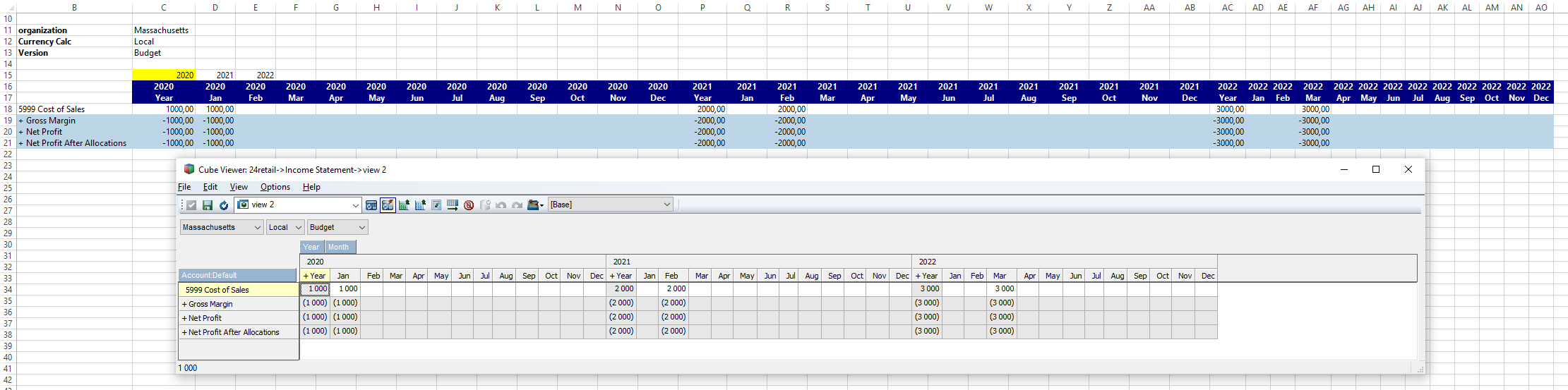

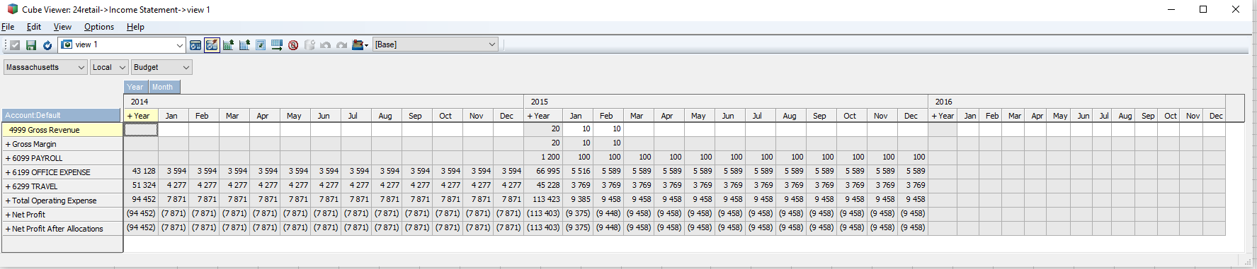

I did some testing in the meantime with the 24Retail TM1 sample menu, "Income Statement" cube.
First, I have the default view but only for Massachusetts, and for 3 years (2014-2015-2016), which IBM implemented as an alias on the elements Y1-Y2-Y3. I removed all rules from the cube. The rows are a static subset containing also the account "5999 Cost of sales" but for Budget 2014-2015-2016 in Massachusetts, it's 0. Cube viewer result:
I bring the view as an Active form to Excel, same result:

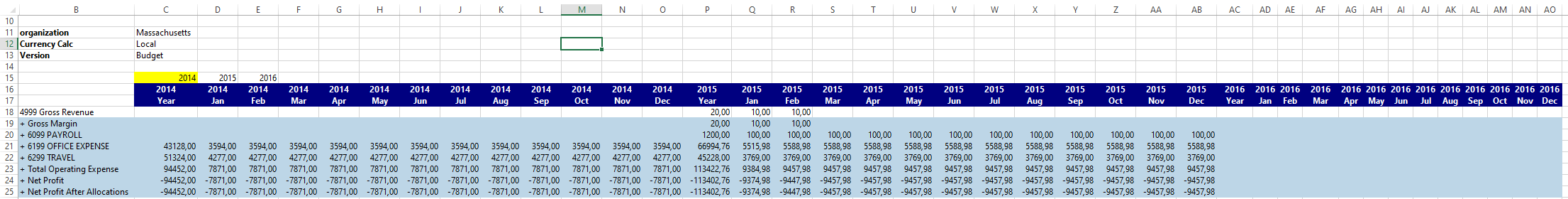

I add some logic in Excel to have the yellow cell with 2014 and the other years as +1 and +2.
In the Year dimension I manually add the years 2020-2021-2022. Hence, they are empty in the cube.
I load 3 numbers, all on account '5999 Cost of Sales' in the future years:
CellPutN( 1000, 'Income Statement','Local','Massachusetts','2020','Jan','5999 Cost of Sales','Budget');
CellPutN( 2000, 'Income Statement','Local','Massachusetts','2021','Feb','5999 Cost of Sales','Budget');
CellPutN( 3000, 'Income Statement','Local','Massachusetts','2022','Mar','5999 Cost of Sales','Budget');
Then in the cube viewer I change the selection to 2020-2021-2022, and the same in Excel after that I put 2020 in the yellow cell, rebuild the active form on the current sheet:
Seems perfect, no ?
Am I missing something ? This approach is what I always did, also with multiple dimensions stacked in the columns. If it works in the cube viewer, why wouldn't it work in the active form ? Isn't the TM1RPTVIEW supposed to take care of this, when we do NOT put the column and row dimensions in the TM1RPTTITLE functions ? To me, the TM1RPTVIEW function would/should take care of 2 things:
- calculation optimizations and view management of cells
- zero suppression of the rows given the selections in titles, rows, columns.

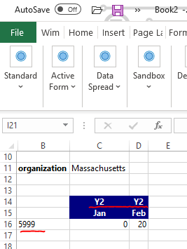

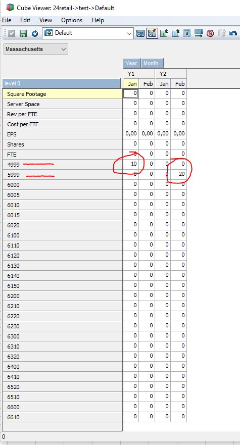

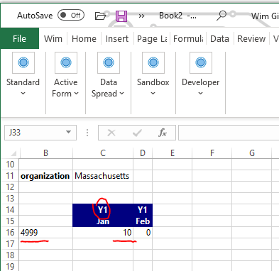

Re: Active form hell
Hi Mark,
Thanks. Let's see if I understand what you are saying.
So if this is a completely new cube without rules, with only 2 data points for 4 dimensions:
Then I have data on account 4999 in January (Year 1) which is a column dimension.
If in my active active form I ask the months of Jan and Feb, in Year 1, I see account 4999:
If in my active active form I ask the months of Jan and Feb, in Year 2, I see account 5999 only, no 4999:
Shouldn't I see account 4999 if I follow your line of reasoning ? Because somewhere, for Massachussets, I have on 4999 data on a different year but still on January which is in my column selections.
The rows is each time a level 0 dynamic subset.
Thanks.
Mark RMBC
Posts: 296
Version: 10.1.1
Excel Version: Excel 2010
Post by Mark RMBC »
Hi Wim,
No because you only have one year in each example. In your original rolling 13 you had 2 years in the columns.
Try 2 years and put the value in a month that you don't include on the report, so have Y1 and Y2, Jan and Feb but put 5999 in March.
That way you sort of replicate your original problem.
regards,
