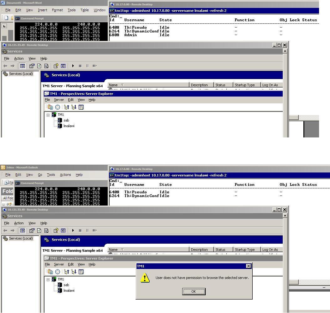

We are experiencing a situation where Perspectives on a planet server can see the star server (lmalawi). However, when we try to login to the star server (lmalawi) from the planet server using the admin account, we get a message ‘The user doesn’t have permission to browse the selected server’. We can connect to the star server (lmalawi) when using Perspectives locally. We’ve tested the ports 5498 and the server’s port number using telnet and were able to connect from planet to star and from star to planet.
What I find odd, is that in the first screenshot below (taken during a login attempt from the planet (10.121.33.49) to the star server (10.17.0.80)), tm1top on the star server shows the admin user connected, but after a few seconds, it disconnects and the resulting message on the planet server can be seen (second screenshot).

Uninstalled FP2 client and reinstalled FP1 client. Now it is working.
