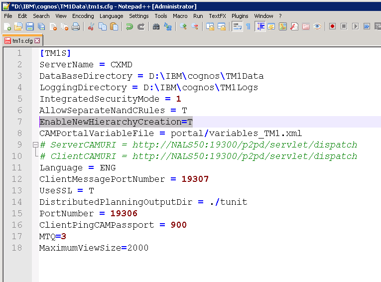

I'm on 11.7.00002.1 so it should be capable of hierarchies but there apparently is an option that isn't set in the configuration. When I am in PAW trying to create a new hierarchy it spits an error "New hierarchy creation is disabled"
The server admin is out on personal leave for the next two weeks. I have server-side access so I could stop/start/modify aspects of the server but I'm a newb-nugget on TM1, I don't want to break anything. Do you know if this is difficult to enable?

20 Ton Squirrel wrote: Mon Aug 17, 2020 7:50 pm Thank you both for the advice! I had not considered how the dimension count would detriment the user experience. Most of the end-users are techno-phobic and opposed to moving into TM1, I must be very cautious in my development for user acceptance. :)
It's not difficult. Did you use google on: "New hierarchy creation is disabled" ? But be sure to know what you are doing...

WOO! After scouring around for a bit I found where the config file was and added the line. After a restart of the server I was able to create a new hierarchy in PAW!
