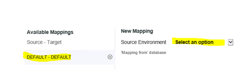

I have both databases ( Dev and Test) on the same server, one called FnP_Dev and the other one FnP_QA
I created all the books and views in DEV and now when I try thing Life Cycle Management to migrate them to QA, yes the package gets created and it gets migrated, but all the Views are still pointing to DEV Cubes
I have only one Workspace Server and there I have 2 databases setup.
And I cannot see how I can even change the Database name in the Views
WHen I go to setup SOurce to Target Mapping, on the Drop Down for Source I have Only "DEFAULT" and on the Drop Down for Target I also have only "DEFAULT"
Is there any way to change the Database Name after the Vews are migrated?
Workspace_Source_target Mapping.PNG (21.52 KiB) Viewed 21224 times

tm123 wrote: Fri Aug 21, 2020 10:52 am Hi,
Thanks for sharing this.
Yeah, I had the same problem, that's why I had to export the image and change the "server-name" setting manually and then re-import the image to paw, like I mentioned in the opening post. Did you try that method?
