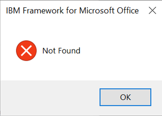

When I have excel open and run the macro manually the entire process works through to the emailing however when i try to run it outside of excel I get the following error

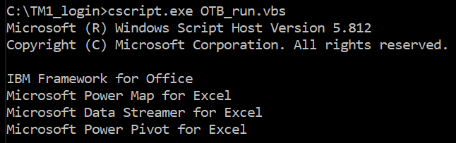

I have enabled in my code
For ndx = 1 To objExcel.Application.COMAddIns.Count
      	WScript.echo objExcel.Application.COMAddIns(ndx).Description
Next
However it still doesn't seem to work. Would really appreciate some help/guidance on this!

Re: PAX API - error when calling macro
Post by Paul Segal »
This looks like a Windows issue, rather than an api issue, see https://www.tm1forum.com/viewtopic.php?f=3&t=14157
Paul
