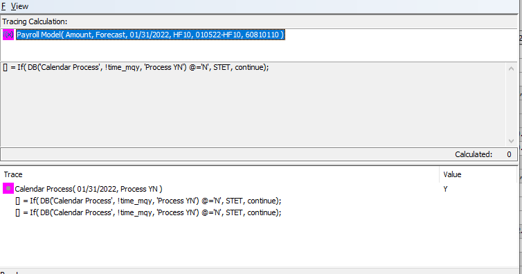

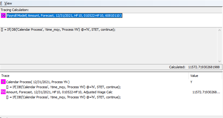

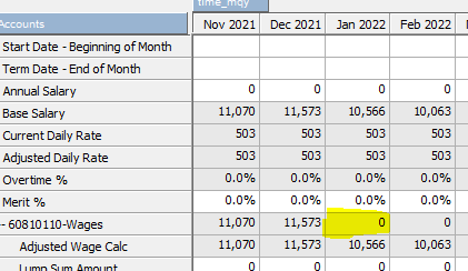

I cannot seem to get the wages line to populate (yellow highlight) as can be seen in attachment "Wages Screen". Other lines such as Adjusted Wage Calc are populating, so I don't believe the issue is Dimension or Dimension Attribute related. I have attached files showing the Dec 2021 & Jan 2022 "Trace Calc" results for account "60810110 - Wages". Also, the Calendar Process for both Dec 2021 and Jan 2022 are set to "Y".
I appreciate your assistance helping me solve this issue. If more information is needed, please let me know, I just didn't want to post too much or unnecessary detail.

The issue is not with the calculation but with the feeding. The screenshots of the rule trace don't help at all as due to the Continue the tracer only shows the FIRST rule which applies to the cell and not the FINAL AND ACTUAL calculation. But in this case it doesn't matter as the screenshot of the cube view gives the answer.
You can see that the leaf intersection of Adjusted Wage Calc / Jan 2022 contains a value. This tells us the N: rule to do the calculation is working. But the consolidation 60810110 is 0. Unless there is a C: rule specifying this it can mean only one thing. The leaf cell Adjusted Wage Calc / Jan 2022 is not fed.
All N: rules require feeders. Add the feeder and the calculations will sum up as the dimensions consolidate.

bbrady74 wrote: Tue Jun 23, 2020 7:45 pm Why does the consolidation work for Dec 2021 and stop working for Jan 2022? If the Dec 2021 is working, shouldn't the Jan 2022 continue to be viable?
No, these periods are not linked. As said, there is an issue at the level of the feeder (they are wrong or just left out where they should not be left out).

scrumthing
Posts: 81
Version: 11.x
Excel Version: MS365
Re: Data Not Moving to Cell
Post by scrumthing »
From a quick lock at the rules and feeders I would suggest you look at ['Amount', 'Forecast','time_mqy':'comment', 'Annual Salary' ]. That seems to kick it off. Check if that cells behaves differently. For everything else IMO someone has to check that cube in more detail. But it is already late so maybe I am mistaken.

scrumthing wrote: Tue Jun 23, 2020 9:25 pm From a quick lock at the rules and feeders I would suggest you look at ['Amount', 'Forecast','time_mqy':'comment', 'Annual Salary' ]. That seems to kick it off. Check if that cells behaves differently. For everything else IMO someone has to check that cube in more detail. But it is already late so maybe I am mistaken.
Thank you, Scrumthing. I have check the "comment" is populated as of Oct 2019 and that is the date my "Annual Salary" field is populated. This issue is pervasive for all the fields in January 2022 and forward.
Post by ascheevel »
['Amount', 'Forecast','time_mqy':'comment', 'Annual Salary' ] =>
   DB('Payroll Model', 'Amount', !Version, 'Total of Time_MQY', !regioncc, !cc_emp,'Base Salary'),
   DB('Payroll Model', 'Amount', !Version, 'Total of Time_MQY', !regioncc, !cc_emp,'H_Base Salary Days in Payroll') ;
Is the element Jan 2022 a descendant of the consolidation Total of Time_MQY?
Post by ascheevel »
Good. One test you could do is recreate the cube view from your initial screenshot with only the measures Adjusted Wage Calc, Adjusted Daily Rate, Current Daily Rate, Base Salary, and Annual Salary selected and then move your time dimension up to the context filter and turn zero suppression on. When you toggle between Dec 2021 and Jan 2022, are there any other rows besides Adjusted Wage Calc that disappear meaning they're not fed. Looking at your feeder statements, Adjusted Wage Calc is fed from Adjusted Daily Rate and Adjusted Daily Rate is fed from Current Daily Rate and Current Daily Rate is fed from Base Salary and Base Salary is fed from Annual Salary and Annual Salary is fed from what's inputted in time_mqy:comment. Somewhere in that feeder chain is a break and the zero suppression will hopefully help you see where.
Another questions: is the Month_After attribute populated for Dec 2021? If not, that would prevent Base Salary from feeding the next month in the feeder statement below. If it was only just recently populated, you may need to reprocess feeders on the cube.
['Forecast','Adjusted Daily Rate'] => DB('Payroll Model', 'Amount', !Version, !Time_MQY,
Post by bbrady74 »
Thank you for the response. I tried re-processing the feeders and it worked :!: I have not had to do that in the past, but thank you for the suggestion!
