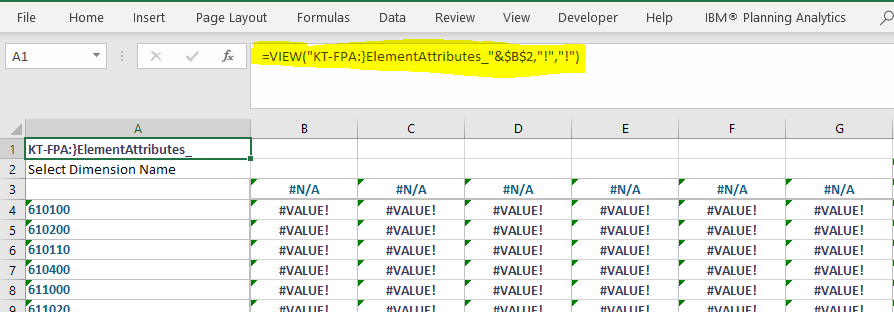

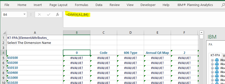

'tomok wrote: ↑Tue Jun 16, 2020 5:39 pmEasy is a relative term. If you are new to Planning Analytics then it isn't going to be easy for you. Basically, you need to create an active form report out of any of the }ElementAttributes cubes and then change the TM1RPTVIEW formula to pull the first parameter from the results of a drop-down that has all the }ElementAttributes cubes in it. You can then modify the columns to pull the actual attribute elements by numbering the columns, 1 thru whatever, and putting a DIMIX formula in each column to pull all the individual attribute elements. Now, whenever a user selects one the attribute cubes from the drop-down and rebuilds, it will show all the attributes for that dimension. That's it in a nutshell.
Hi, really thanks a lot for replying me, need some clarification please,i have created a active form report out of one of the }ElementAttributes cube
and made the changes to TM1RPTVIEW formula to pull the first parameter from the results of a drop-down that has all the }ElementAttributes cubes in it, and now comes the DIMIX formula in each column, please see the screen shot, is that correct,i have altered only for the first column remaining i didn't change yet
- att.PNG (24.97 KiB) Viewed 11269 times
Re: Changing Quick view depending on cell drop down
Your DIMIX isn't going to work because you have a circular reference. The second parameter in that formula is an index number, 1 thru whatever. You can modify the formula to be DIMIX(Server:Dim, 1)....DIMIX(Server:Dim, 2)...DIMIX)Server:Dim, x) or you can add the index number in a cell above and reference it.

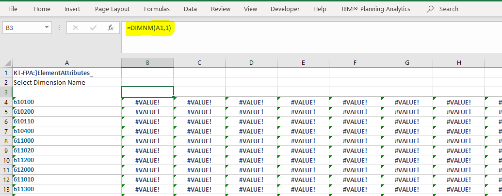

Hi cool, it works i have used DIMNM to fetch the attributes columns screen shot, Thank you so much for helping metomok wrote: ↑Wed Jun 17, 2020 8:04 pm Your DIMIX isn't going to work because you have a circular reference. The second parameter in that formula is an index number, 1 thru whatever. You can modify the formula to be DIMIX(Server:Dim, 1)....DIMIX(Server:Dim, 2)...DIMIX)Server:Dim, x) or you can add the index number in a cell above and reference it.
but what about the elements in the cub how will that fetch when i have used DIMNM it is fetching the attribute name but how can we fetch the
element name, can you please let me know
- Capture.PNG (26.74 KiB) Viewed 11227 times

Cell A1 seems to have a servername, then }ElementAttributes, then nothing ? No dimension name at all ?

My server is only : KT-FPAWim Gielis wrote: ↑Thu Jun 18, 2020 7:34 am Please do not skip TM1 101 classes...

the dimension is fetching from B2 as you told
Then it should work, provided that B2 holds a valid dimension name.
What is the formula in B4 and similar cells in the grid ?

=DBRW($A$1,$A4,B$3)
Everything is working fine, when i am changing the dimension it is fetching all the corresponding attributes from that dimension
But .... the elements are constant it is not changing, is there any function like DIMNM() to fetch elements from that dimension ?
Maybe because this appears to be a custom report and not a dynamic report. If it were a dynamic report the formula in A1 would be TM1RPTVIEW and not VIEW.kalyan846 wrote: ↑Thu Jun 18, 2020 8:47 am =DBRW($A$1,$A4,B$3)

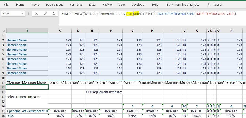

Ok now i have taken a new dynamic report and i have made the changesWim Gielis wrote: ↑Thu Jun 18, 2020 10:45 amIndeed, good catch tomok.
If the OP just starts with a dynamic report on the relevant cube, it would have been much easier.
but can you please let me know how to coordinated the =TM1RPTVIEW("KT-FPA:}ElementAttributes_Account:40173141",0,TM1RPTFMTRNG40173141,TM1RPTFMTIDCOL40173141) the "Account" part need to change to C14
