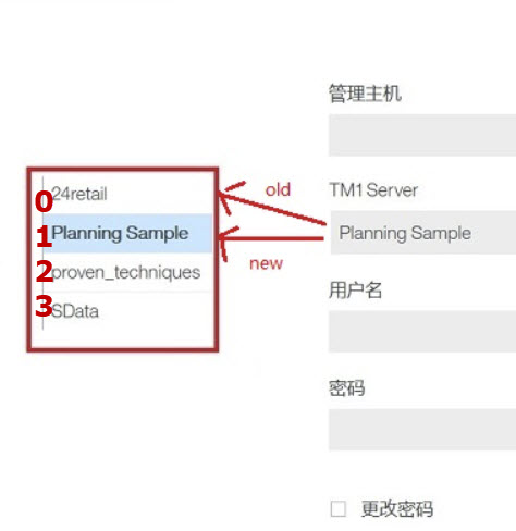

When logging into tm1web, TM1 server displays the first server in the server list, which may not be the server name we expected. Use Notepad to open ibm\cognos\tm1_64\webapps\tm1web\scripts\tm1web\standalone\TM1WebApp.js, and find this._serverNameSelect.set("value",a[0].value), and change 0 to 1, and save. Open the browser and input http://172.17.210.18:9510/tm1web, TM1 server has changed.
(for IBM Planning Analytics 2.0.x)

Something else to keep in mind is that the 0/1 switch that abcthing dictates is a list index where the desired new default selection Planning Sample is the 2nd item in a list where the first item is item 0. If you instead wanted proven_techniques to be the default selection you'd use 2 instead of 1. If at some point you create another TM1 model on the same admin host called for example "48retail", it would fall between 24retail and Planning Sample and you'd want to update the list index in the function to still have the desired default Planning Sample selected. e.g. if you had been using 1 to select Planning Sample by default, you would need to update the list index to 2.
